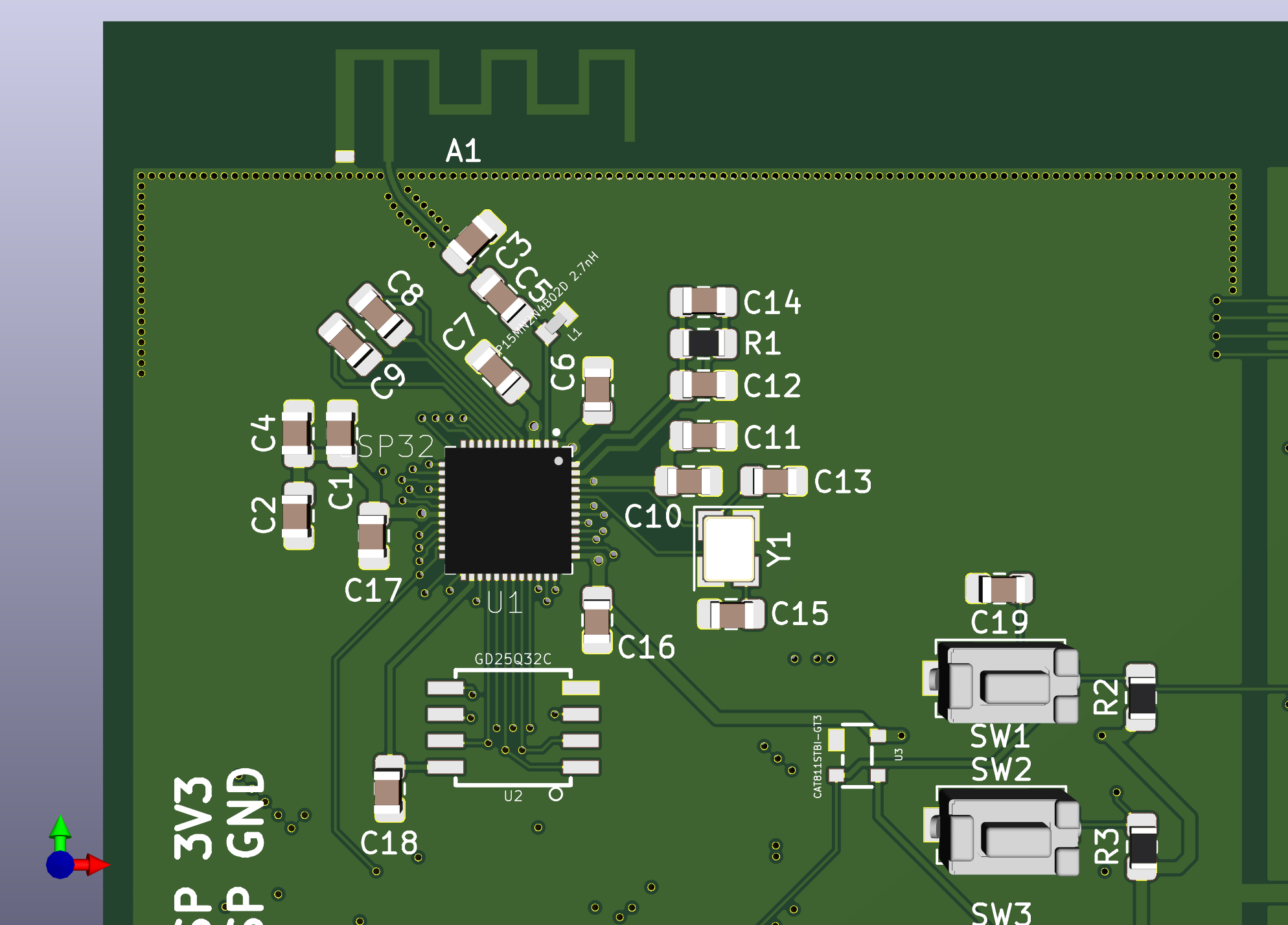

Hi Angus,
Can you share the specs for the PCB antenna design? I don't have Pads software to read reference PCB design to measure the dimensions.
Thanks,
Prasad.

Hi Prasad,
The Reference Designs should include a directory with design files in the industry standard Gerber format. A Gerber viewer (free ones available for most platforms) should allow you to look at the specific dimensions of the PCB antenna.
Note that PCB antenna design can be PCB fabrication process dependent, so you may need to test prototypes and tweak them a little to get optimal performance.

Postby _Prasad » Tue Nov 27, 2018 3:45 pm
Ohh why didn't i notice that. Dumb me :lol: Thanks Angus, Just checked with KiCad Gerber Viewer and i can measure the antenna dimensions. Btw i have already sent one prototype to fab with TI's SWRA 117 reference antenna specs, lets see how that goes too :)

Hi Angus,
Just for the reference here is my KiCad 3D rendering which i have already sent for fab. Indeed dimensions of this antenna is bit different from the reference antenna. but i'll post the result anyway when it arrived.
Thanks,
P .

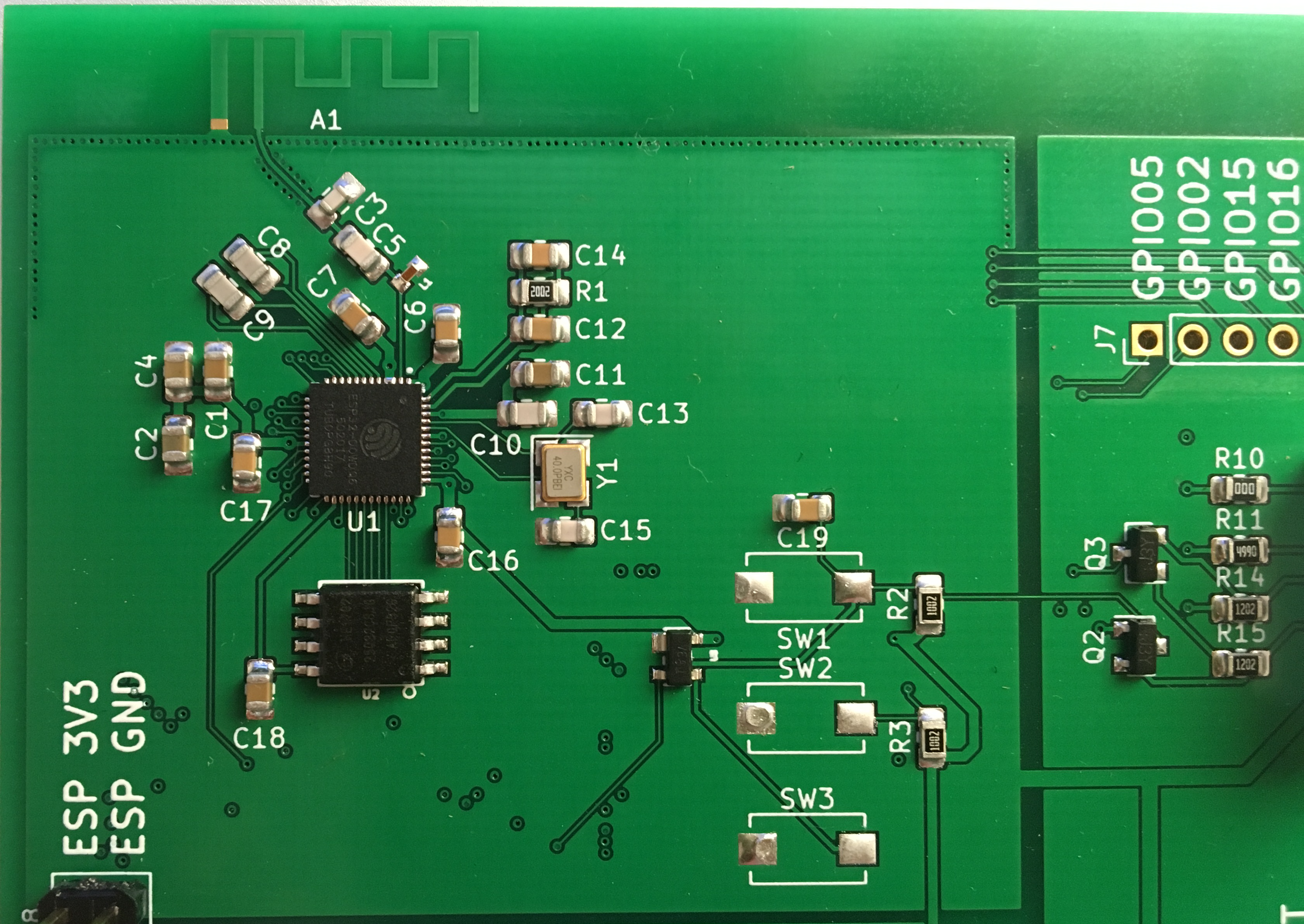

Hi Angus,
I have assembled my PCB design with SWRA 117 antenna. And i must say it works a treat. I have tested bluetooth connection upto 20 meters with obstacles(Haven't tested with line of sight distance yet) and it maintained the connection.
Btw how do you define the optimal performance?
For the reference i used SWRA 117 antenna which came with KiCad default footprint library. And for the fab i used JLCPCB.
Having all that said i'm gonna change the antenna to the recommended dimensions when i'm doing the final miniaturized PCB design. This is more of a proof of concept of our product(rest of the PCB is a secret squirrel ;) ).
Here is the picture of it,
