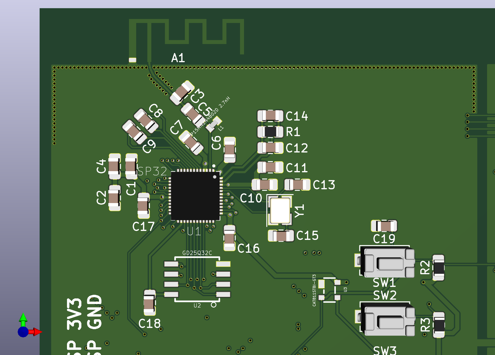

Hi Angus,
Just for the reference here is my KiCad 3D rendering which i have already sent for fab. Indeed dimensions of this antenna is bit different from the reference antenna. but i'll post the result anyway when it arrived.
Thanks,
P .

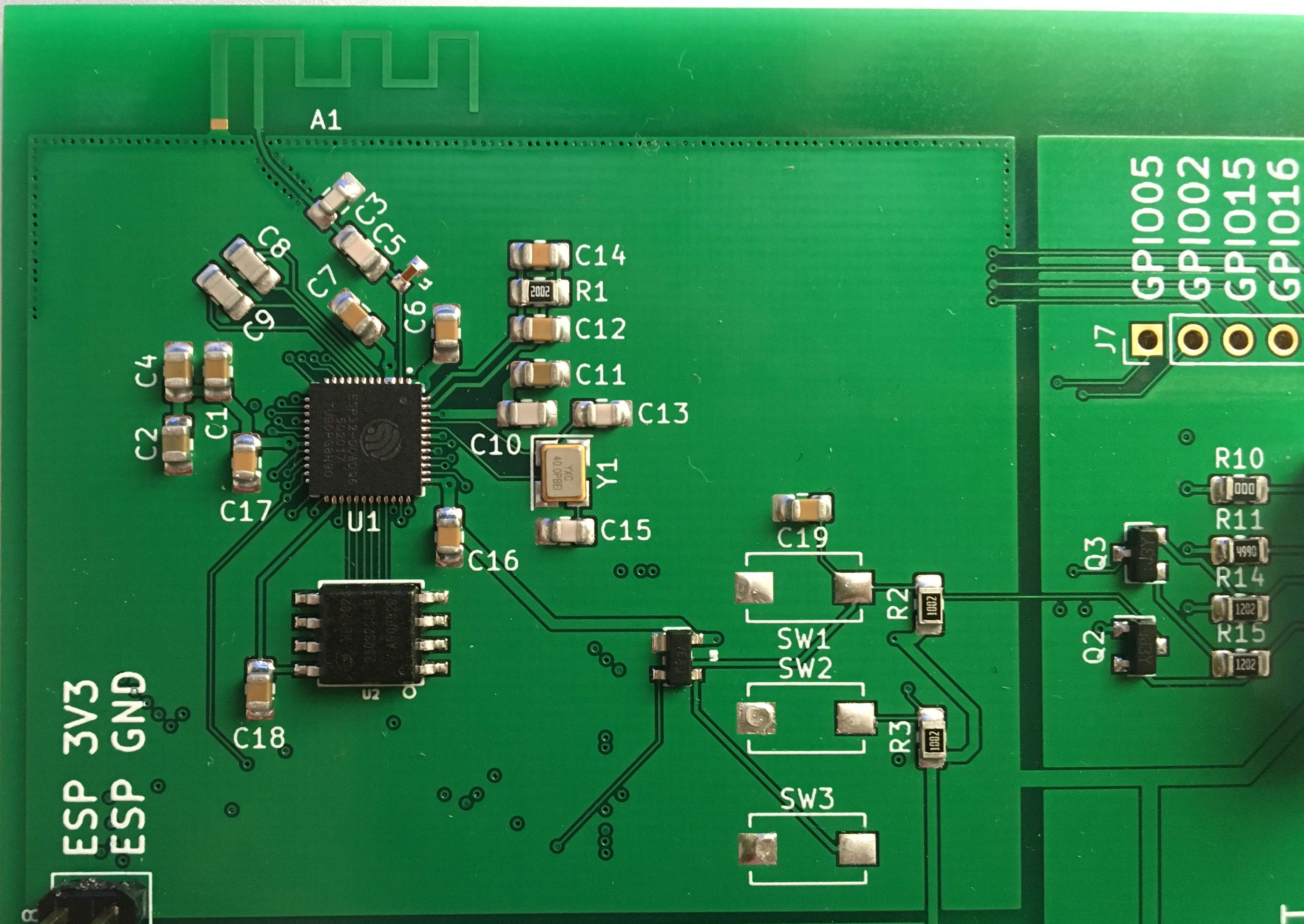

Hi Angus,
I have assembled my PCB design with SWRA 117 antenna. And i must say it works a treat. I have tested bluetooth connection upto 20 meters with obstacles(Haven't tested with line of sight distance yet) and it maintained the connection.
Btw how do you define the optimal performance?
For the reference i used SWRA 117 antenna which came with KiCad default footprint library. And for the fab i used JLCPCB.
Having all that said i'm gonna change the antenna to the recommended dimensions when i'm doing the final miniaturized PCB design. This is more of a proof of concept of our product(rest of the PCB is a secret squirrel ;) ).
Here is the picture of it,
Kind Regards,
