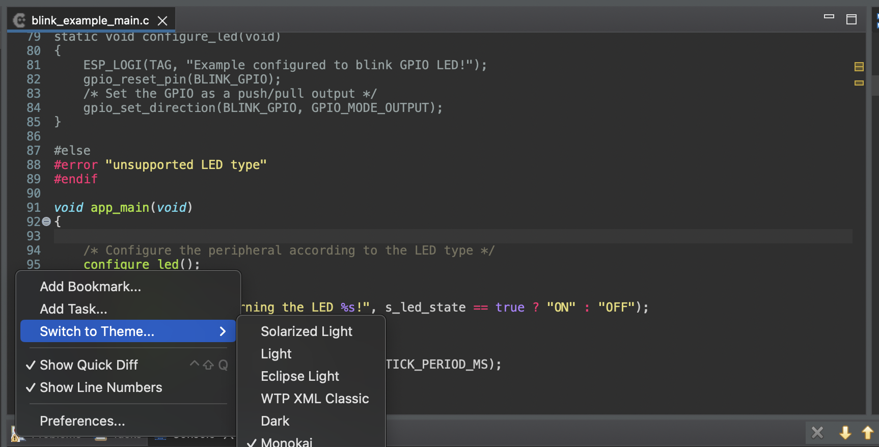

So, I've been forced to upgrade to IDF v5 due to some specific bugs in v4. Therefore I am forced to use IDE v3 as there is no other viable option (VSCode may be good for web, but not for embedded).
So, to change theme you now have to right-click in editor and use Switch to theme. The TextMate Theme option in Preferences does nothing.
But provided themes don't suit my preferences well - even the Eclipse Light theme is somehow worse than the old eclipse default (which is very surprising considering how basic the old one was). So I would like to change some colors, but so far I have not found any way how to do it.

This works based on the TextMate color themes. You can change the settings. I understand it is completely different compared to the old C/C++ Editor.
Please refer to this.

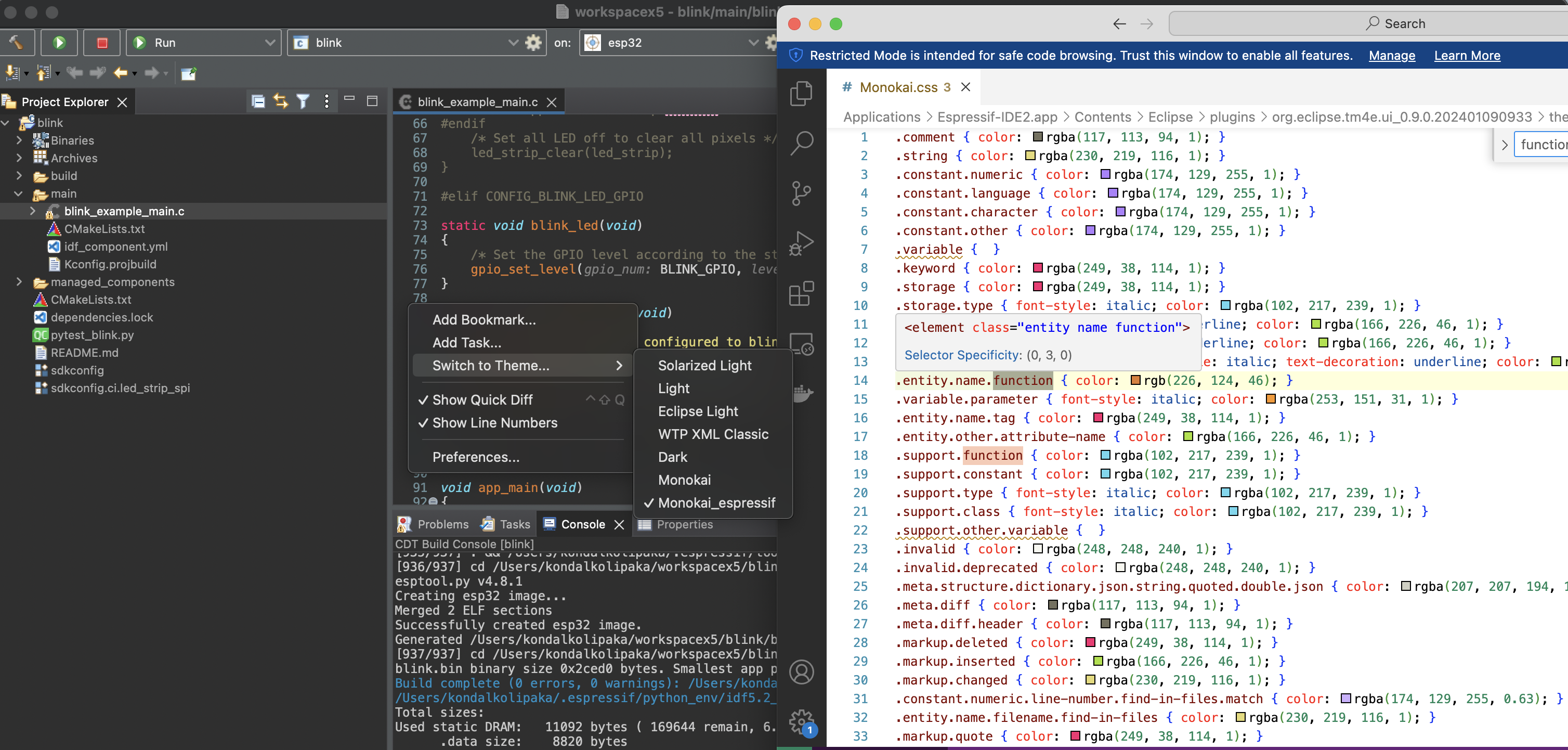

For a thought experiment, I changed the default method color and imported the `Monokai_espressif.css` file into TextMate themes, applying it in the editor.

So it looks like, in theory, I could make a new .css file matching the colors to the previous palette and it would end up looking like the old c/c++ editor syntax?

Yes, that’s the way to go for now. In future releases, we can try to bring this into the preferences settings, similar to the old editor.
If you’re planning to modify these .css files, you can refer to them here:
https://github.com/eclipse-tm4e/tm4e/tr ... .ui/themes
Thanks!
