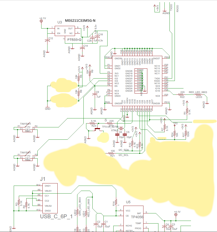

Schematic with secret parts blurred out
What's the deal with GPIO2 ? Sorry I didnt know there was a GPIO2 requirement as well.
Here is the schematic - at least the parts that I can show. Nothing weird about the circuit. I can try again to look for ripple on the Vcc line but it looked amazingly clean and teh voltmeter didnt flinch when I hit reset. not even a movement by .1 volt.
The LiPo is 1000 mAh and I've used this LiPo on other ESP32C3 circuits and it worked perfectly.
I agree the 6 mA is suspicious

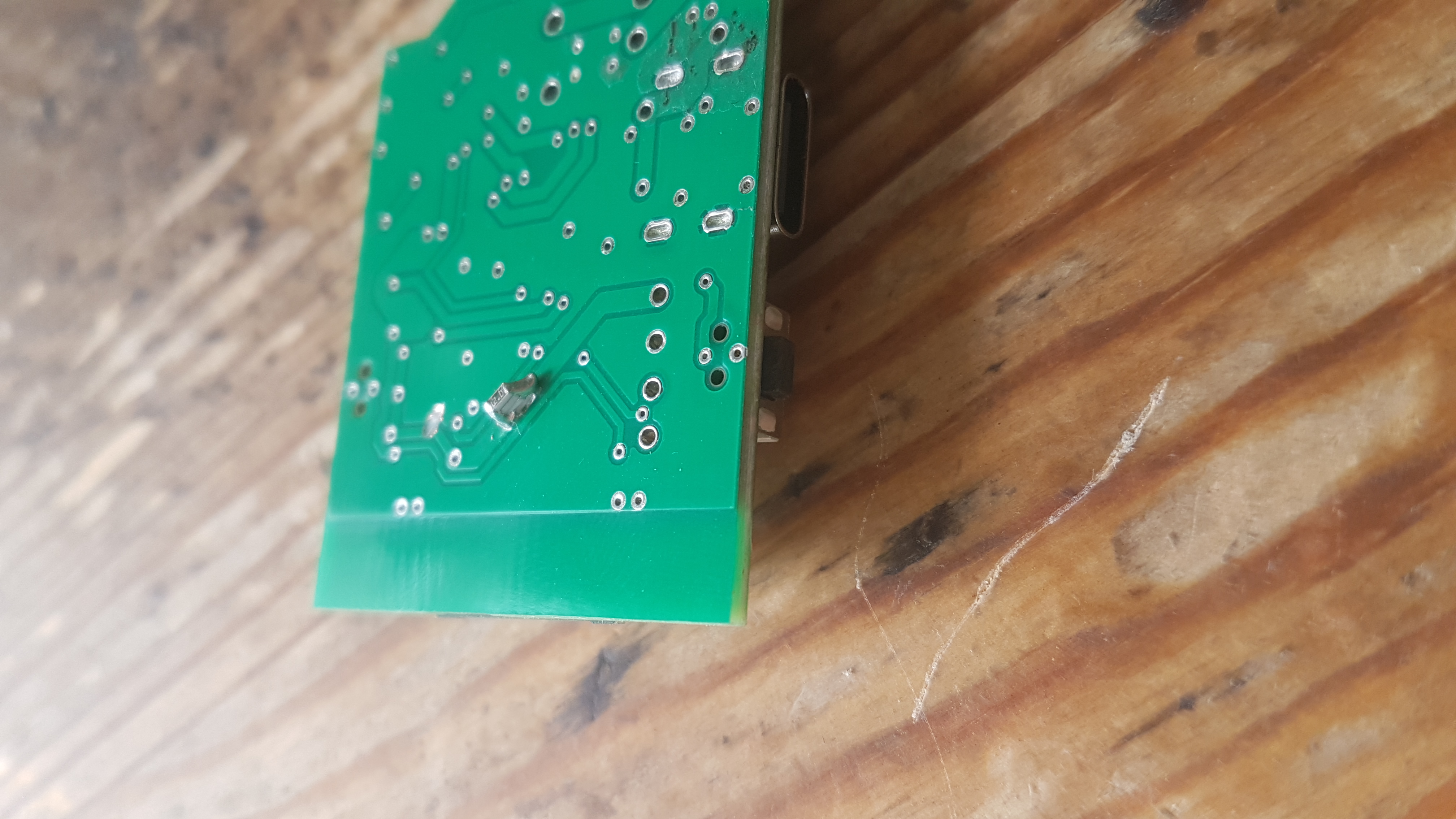

Alright so I took a dremmel tool and obliterated one line going to GPIO2 just in case it was pulling it down in voltage at all, since the technical reference manual also specifies that GPIO2 must be high for any kind of boot. Did that. Checked with the voltmeter. Perfect 3.3v on GPIO2, 3.3V on GPIO8, and 0v on GPIO9.
Still the same problem 6mA

Added a 0.5 ohm shunt before the Vcc input of the ESP32C3 module
I put in a little 0.5 ohm shunt right before the via that goes up to the Vcc pin of the ESP32C3 module. A little stack of 2 ohm resistors.
Last night I was only measuring the input to the regulator, but now measuring directly by using the new improvised shunt.
The measured current going into the module is 7.9 milliamps when EN at 3.3V, and the current is 0.0 milliamps when EN is brought to 0 (the reset condition). Then the input current returns to 7.9 milliamps when EN brought back up to 3.3 V.
