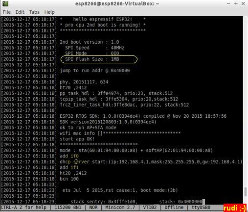

Postby rudi ;-) » Thu Dec 17, 2015 4:27 pm
finally got the board run.
btw, which ESP board you have?
(8MB, 16MB, 32MB, 1Mbit)
