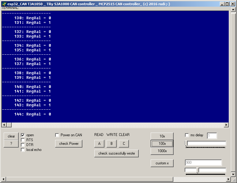

part1:
- without Delay
- example 100x
response:
0: RegVal = 0
1: RegVal = 1
143: RegVal = 1
144: RegVal = 0
usually here must come the last IDX Counter with 199
100 x 2 ( reads ) start with 0 = 199
198: RegVal = 0
199: RegVal = 1
here are missing the response data
(lines with \r\n at end) from 145..197

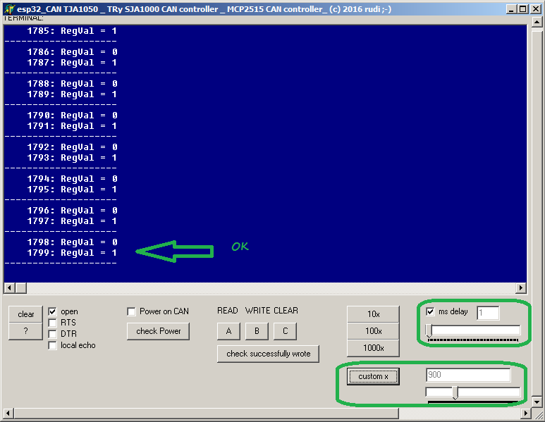

i change this now like this:
i put a delay between each comport1.send
the delay was done with 1ms
result now:
- no hw fifo err comes
- no ringbuffer err comes
100x
the response is ok and like it must
900x ( 900 x 2 reads = 1800 - 1 = IDX 1799
0: RegVal = 0
1: RegVal = 1
1798: RegVal = 0
1799: RegVal = 1

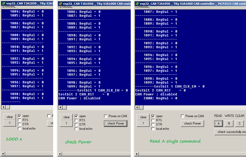

1000x ( 1000 x 2 reads = 2000 -1 = IDX 1999
the response is not ok, and like this:
0: RegVal = 0
1: RegVal = 1
1898: RegVal = 0
1899: RegVal = 1
( see last picture left side "1000 x " )
there are missing 11x char '-' from the line
and the \r\n at end
then is missing the data
1900: RegVal = 0
1901: RegVal = 1
1998: RegVal = 0
1999: RegVal = 1
pulsing with an other command is not helping to response
the missing datas..
( see last picture in the mid "check Power" )
FYI:
the processing ( counter IDX ) for the missing datas
is done on the ESP because if i send a manually command
like
comport1.send('A'); // Read ...
the idx is response with the next "right idx"
2000: RegVal = 0
( see the last picture right "Read a single command" )
and so on
