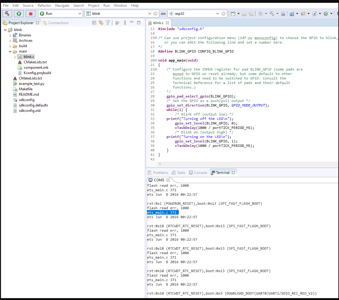

hi ,
please some one can help me ?
i have problem, when i enabled flah encryption development mode, the size of bootloader (0x7000 = 28672 BYTE) increase , so to solve that i increase the partition table offset from 0x8000 to 0x10000, that work in the first boot, but when i reset esp32 i have this error in TERMINAL :
pic
