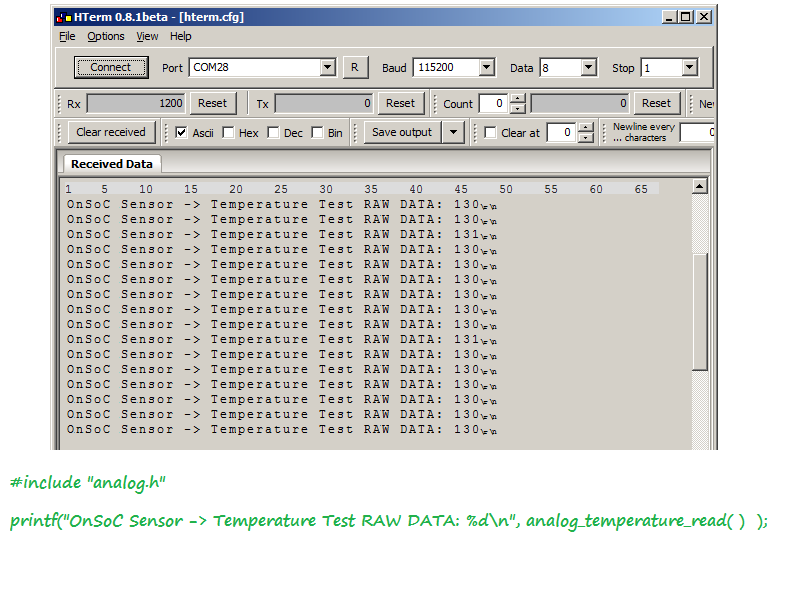

But where is adc1_read? ROM function not provided?

Postby rudi ;-) » Tue Nov 15, 2016 1:46 am
btw:
Add the ADC class in the machine module
from machine import ADC
adc = ADC(0)
adc_c = adc.channel(pin='P13')
adc_c()
adc_c.value()
src
not found just in time in c code - we must search :mrgreen:
( each lib expand and searching in txt file )
but
OnSoC Temperature Sensor found and runs:

Postby WiFive » Tue Nov 15, 2016 2:12 am
Oh I see it is in librtc.a. Check map file.
