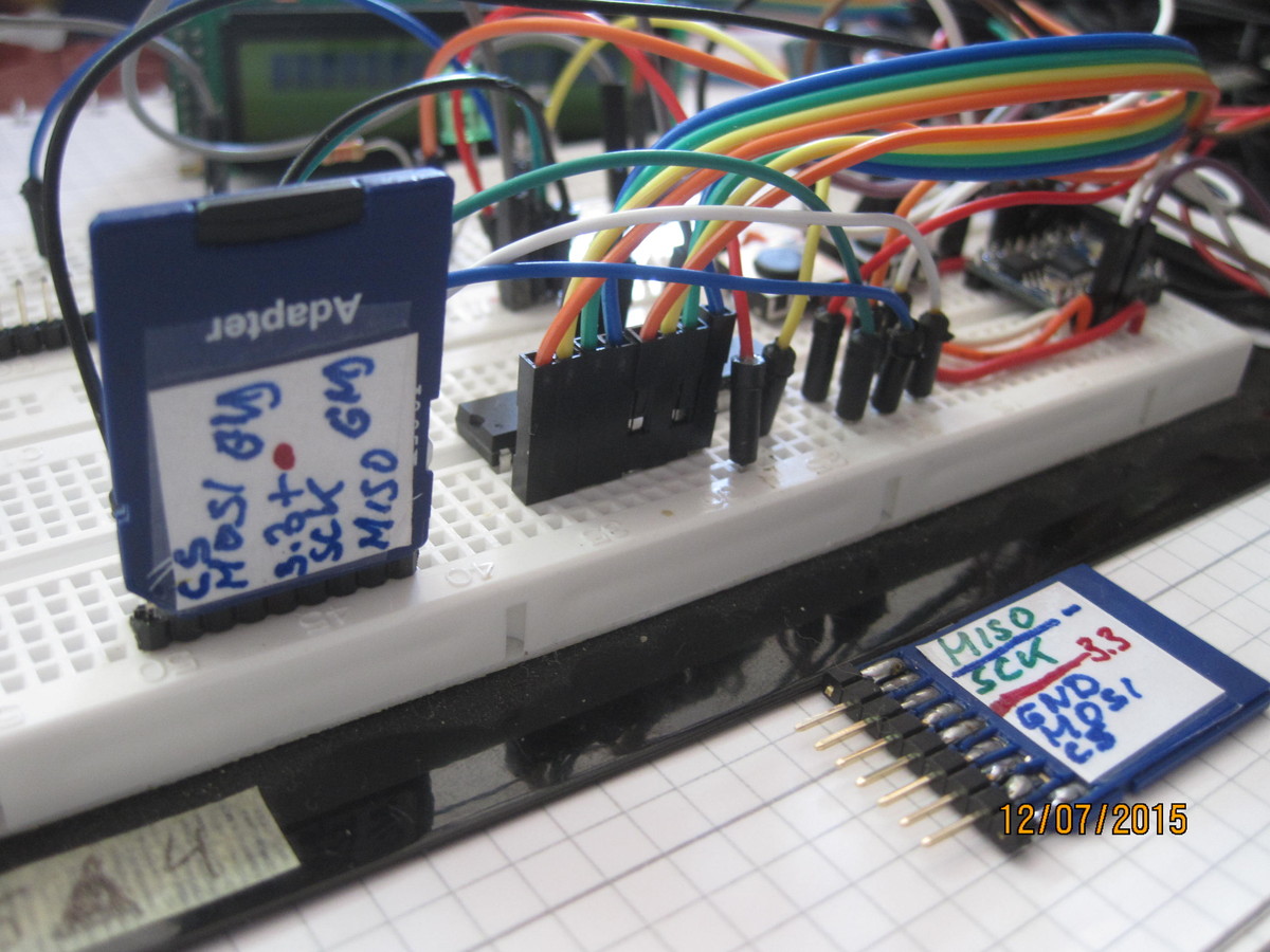

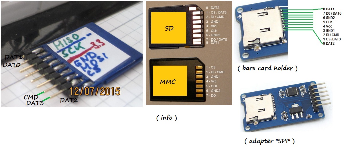

Re: SDIO Interface
@novalightnovalight: can you capture the failing transfer using a logic analyzer?
and if possible, can you say, how and with which components you have build the test. do you have a bare sdhc socket
on a bare esp32 or do you use a esp32 board ( which ) and a sd(hc) card component ( see pictures ) or like this selfmades ( parts from my own esp8266 sdhc test).
rudi
