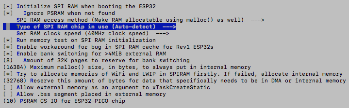

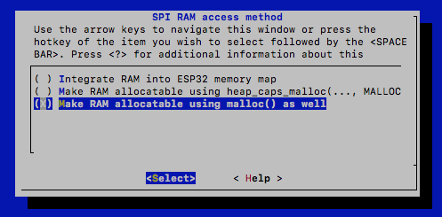

It seems it is related to fread/fwrite functions.
When the arguments to those functions are buffers allocated with calloc, sdcard (or FATFs) hangs.
On the other side, when using static buffers declared with buffer[16384], everything works fine, no more hangs.
Nobody else observed this issue ?
Menu config is configured as shown in the screenshot, anything that may cause such a issue ?
Thanks
Posts: 10612
Re: I2S Record to SDCard using FATFs
Postby Sprite » Fri Mar 15, 2019 2:22 pm
If you allocate buffers that large using calloc, it will also allocate them in PSRAM, meaning the data has to go through another round-trip through the SPI bus. If you allocate them statically, they normally will be allocated in internal memory, which is much faster. That may be the root (and if not, at least a confounding factor) of your problem. Note that you can specify where you want to allocate your buffers by using heap_alloc_caps().
