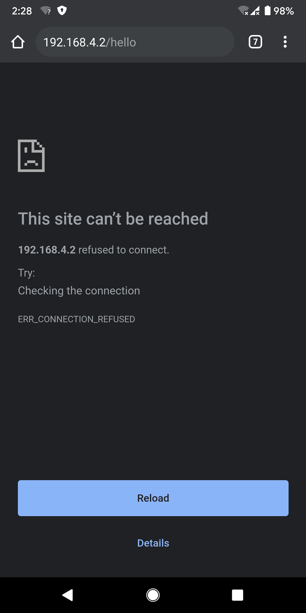

I have to do same things.
I have to take SSID and PWD from the mobile app in AP mode.
I used code that provided in the last.
I want to send Access-Control-Allow-Origin: * in header response.
but going like this Custom-Header-2: Access-Control-Allow-Origin: *
also, I want to send the response {"m":"3C:71:BF:4C:A9:E5"} but nothing got it

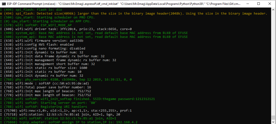

hi
cant share the code, so i will just explain the concepts to get it to work. Literally just slapped these two examples together.
https://github.com/espressif/esp-idf/tr ... ted/softAP
https://github.com/espressif/esp-idf/tr ... ver/simple
as for the "ESP_ERROR_CHECK(example_connect());" in the main of simple httpserver, just replace this example_connect with the init_softAP function from the softAP example. Some points to note:
1.Try to put all the functions in one page. somehow the definitions in different pages seem to cause issues.
2. Use the default settings, the ssid and passwd. Dont do fancy stuffs yet.
3. after combining and compiling, try to solve the errors one by one.
hope it helps.
Thanks, it did.
Here I'm leaving the example code I managed to make. Altough, I encourage everybody to follow the steps stock86c mentioned to truly understand the code (maybe you might end on a better code).

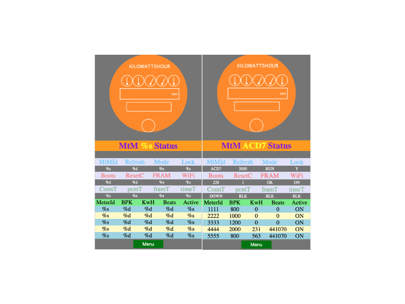

Hi @marchingband.
Instead of writing all the details of a real example, not just a Hello World or echo one, the code attached is a good example.
It will serve html files, the icons associated it as well as the css file. Cache control is important to minimize the ESP32 effort (sendUtils routine show how and how to serve a icon/binary stuff).
To respond with data I use the same HTML template as a format string for sprintf (see attached image fo HTML template and when sent to browser).
sprintf(tempb,(char*)final_start,"nak","Invalid Control Sequence or Session Expired");
httpd_resp_send(req,(const char*)tempb, strlen(tempb));
In this case I have a generic function that does the same, check sendHtml(). See example below
htmlstuff.zip
(2.53 KiB) Downloaded 741 times
Must not include in the HTML section % since the sprintf could go bananas looking for a format instruction and crash. Put it in the css file.
I presume a connection to the ESP32 comes from a cell phone and hence NO connection to the Internet itself. That is, to connect to the ESP32 you must choose the AP of the ESP32 and therefore no access to the Internet. This means jquery cannot be downloaded and used. U could do this if u connect to the STA whose access point is connected to the Internet. But I presume no Internet and hence everything is HTML, css, javascritp at most. JQuery is javascript scripts so u could copy code and paste it in the <script> section of the header.
start_webser() is a task to set stack size, uris # and uris actions, Standard.
webserver.cpp.zip is the code itself
htmlstuff has the Status Html page and the css file (from the example above).

Thanyasit
Posts: 15
Joined: Mon Sep 07, 2020 9:27 am
Re: example of HTTP server in AP mode?
Postby Thanyasit » Sun Nov 29, 2020 7:43 am
I am a beginner
I try to combine two examples together but it was unsuccessful
Please guide me
What should I do?
:cry:
