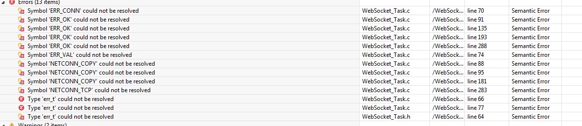

I have little issue with this example.
Am I correct that some includes missing?
UPD:
need to add
#include "lwip/API.h"
in WebSocket_Task.c :)
