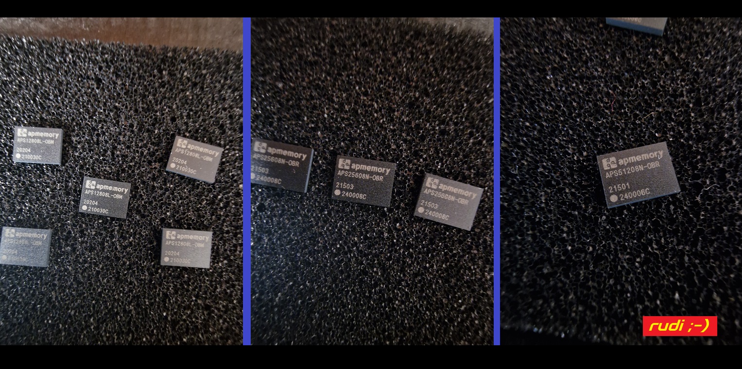

update
in 2023 the psram theme continues :)
128Mbit, 256Mbit, 512Mbit
APMemory:
edit: 18. Aug ' 23
update
128Mbit Psram + 256Mbit Flash successful

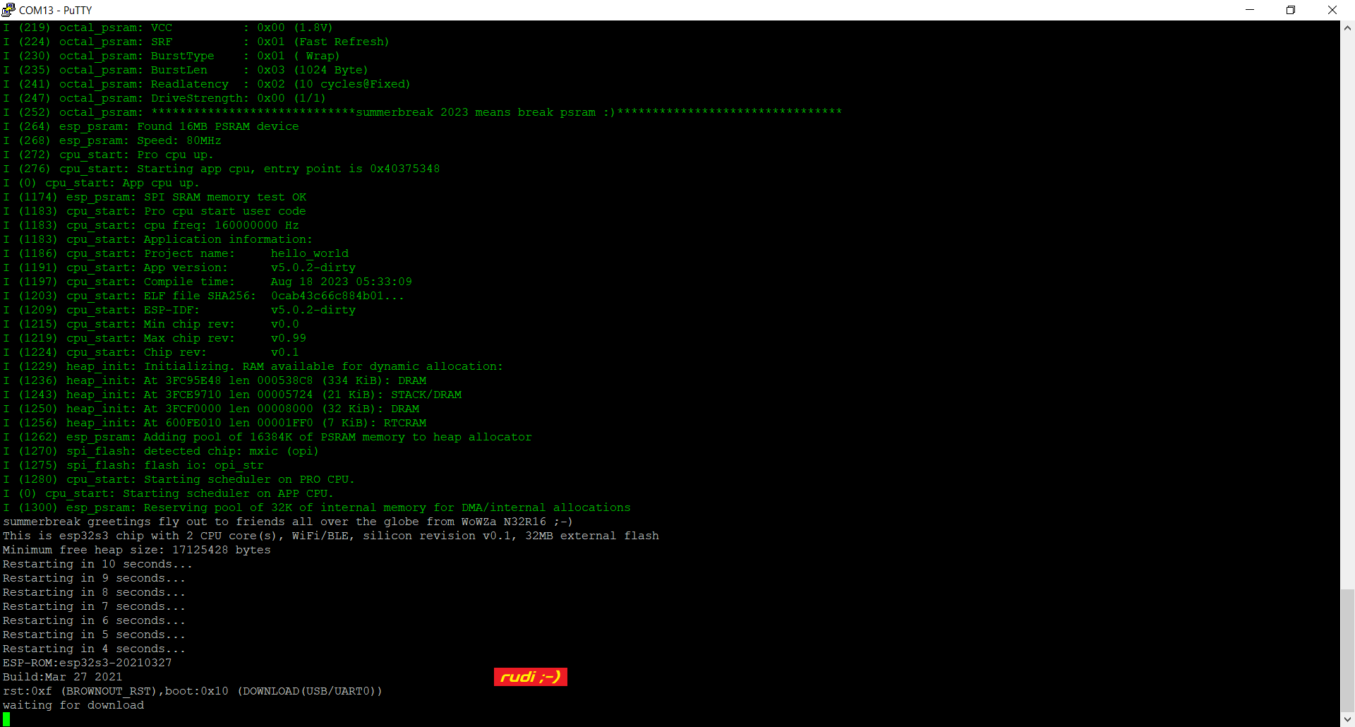

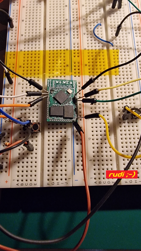

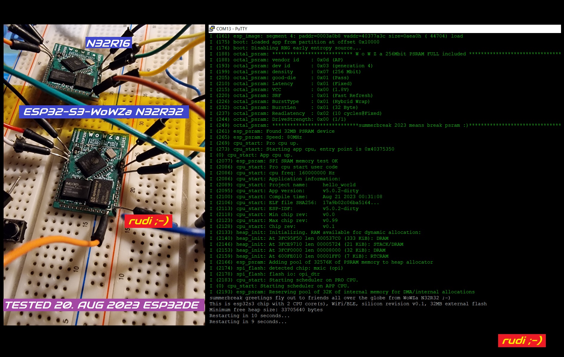

update: 20. Aug 2023
successful 256Mbit ( 1V8 )
20. Aug Done.jpg (707.37 KiB) Viewed 8657 times
next step 512 Mbit
