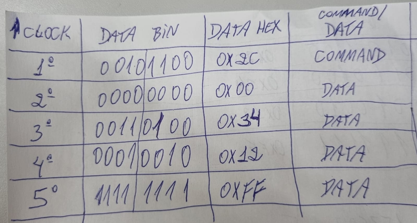

Hi @ESP_Sprite,
Development board: ESP32-S3-DevKitC-1-N8R8.
If i send only one pixel(two bytes) using "edma", the value is correct at i80 bus.
If i send a bigger buffer start giving problem.
I will test and try to find a stable buffer size.
is there a maximum buffer size to work with edma ?
For example: I allocated a buffer with 307200 bytes and sent 200 000 bytes.
I change only the firt pixel to 0x1234.
The first 2 bytes apparently it's ok(i will measure), the third byte get corrupted and the final of "packet" gets corrupted too.
for( uint32_t i = 0 ; i < 153600 ; i++ )  // 1 pixel = 2 bytes
    p_buffer_a[i] = 0xffff;
p_buffer_a[ 0 ] = 0x1234;  // PSRAM send first least significant byte(0x34) then send most significant byte(0x12).
// CPU writes data to PSRAM through DCache, data in PSRAM might not get updated, so write back
//Cache_WriteBack_Addr( (uint32_t)&p_buffer_a[ 0 ], 1 )
int ret = Cache_WriteBack_Addr( (uint32_t)p_buffer_a, 153600 );
printf("\n\nret = %d\n", ret);
Thank's.

Hi @ESP_Sprite,
Development board: ESP32-S3-DevKitC-1-N32R8V
TEST_1:
Allocated buffer: 307200 bytes.
Sent bytes: 307200 bytes.
Test Results:
Only final of "packet" gets corrupted.
 #define pixels_size 153600  // 1 pixel = 2 bytes
for( uint32_t i = 0 ; i < pixels_size ; i++ )
int ret = Cache_WriteBack_Addr( (uint32_t)p_buffer_a, pixels_size );
TEST_2:
Sent bytes: 200000 bytes.
Test Results:
Sometimes it works, sometimes it doesn't work.
When it doesn't work, it looks like that problem( https://www.esp32.com/viewtopic.php?f=5 ... =60#p91835 ).
LCD_CAM.lcd_misc.lcd_bk_en = 1; // BUG mode intel 8080 bus !!!!!
Attached images.

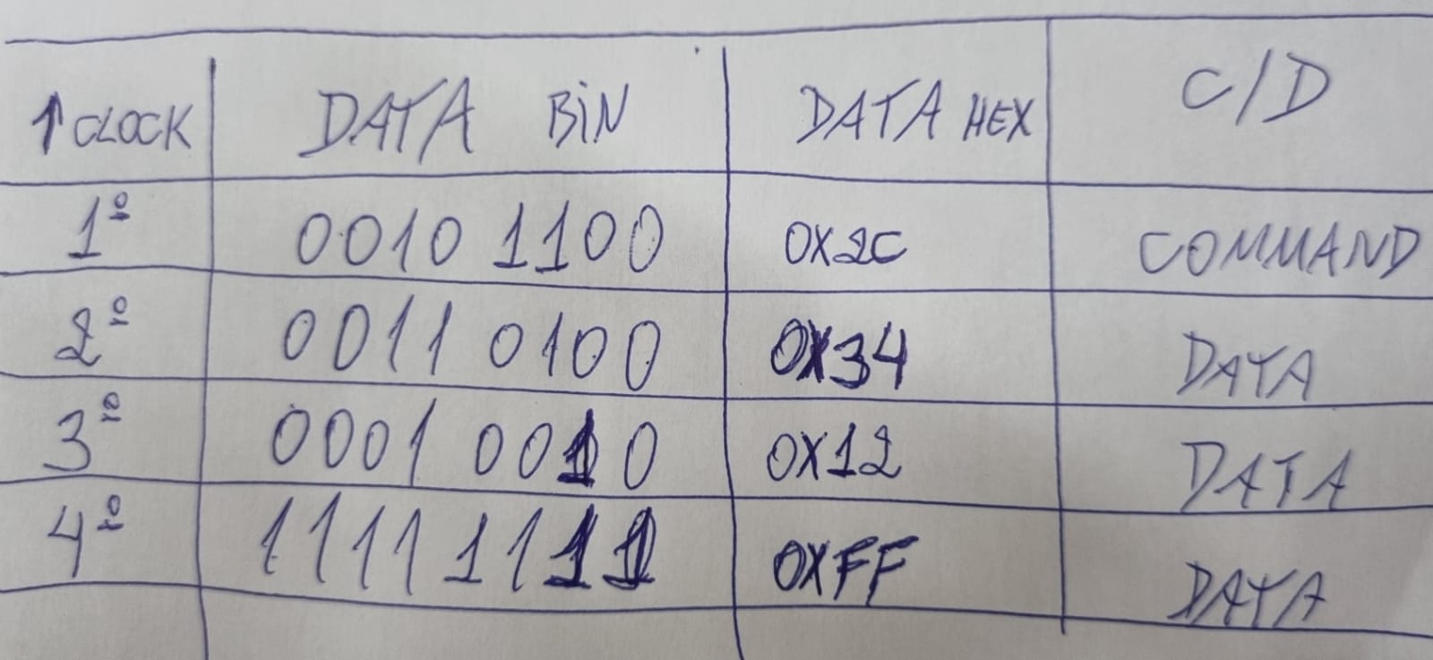

@ESP_Sprite,
It seems that the i8080 with 8 bit bus clock limit, when using gdma with psram, is something close to 20 Mhz.
When i set LCD_CLK = 40 Mhz and LCD_PCLK = 20 Mhz, apparently the buggy second clock problem disappears.
A strange thing i noticed:
Allocated buffer: 400 000 bytes.
Sent bytes: 307 200 bytes.
All OK !!!!!
When i allocate X memory bytes and send X bytes the end of the transmission is corrupted.
From what i realized, i need to allocate more memory than i am sending for the problem not to happen.
Why ???
Could it be that the memory allocation is incorrect ?
Posts: 10593
Re: ESP32-S3 LCD and I2S FULL documentation
Postby Sprite » Tue Apr 12, 2022 8:09 am
At least one issue is that your
seems incorrect: pixel_size is the size of your array of (16-bit) pixels, but the Cache_WriteBack_Addr function needs the amount of bytes, so you're writing back only the first half of the array.
