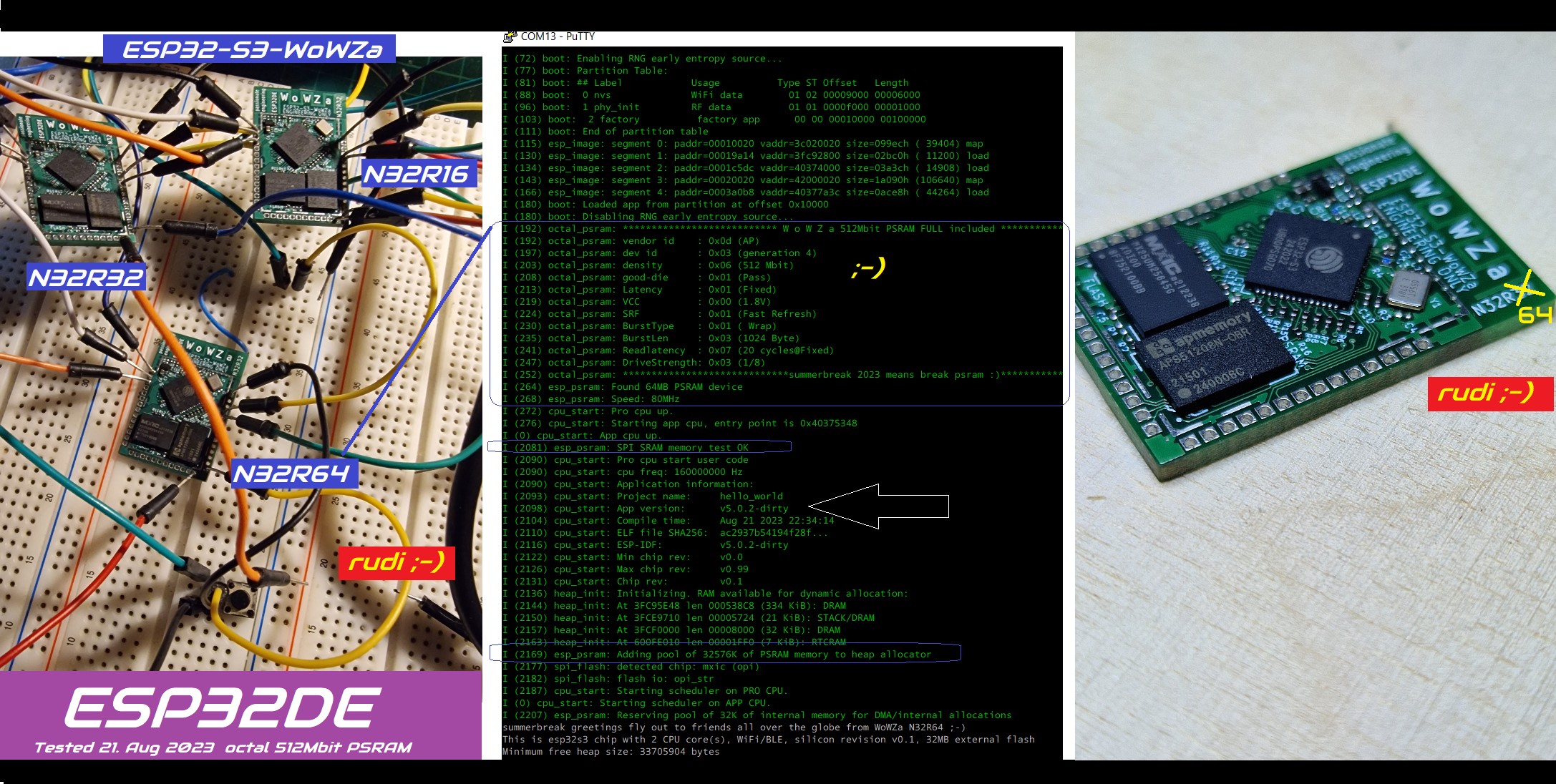

Hi Ritesh
so friendly words :) .. wait for the final, we are now on
update 512Mbit ! psram
21. Aug 2023 ESP32DE
next step:
get here just the same in the heapallocation like the 256Mbit ( 32Mbit )
we can only map 32MB i think - and after this initialize i think we can get more.
i will try to map more psram now into, there are 3 possible ways, step by step, i am on this path for now unti it's done.
i use the 5.0.2 (1) dirty with handwrites edits in the code for check things -
let's see what happens in the next hours. the hardware ( Octal Bus ) is very senitive,
the soldering is not perfect i know :) - but no flying long wire here like in the past 2017 with Lyonteks 8 MB ID check :)
use 4-layer pcb this time and handsoldered 0201 package size for shortly traces.
i will come back to your post again if i go final here in this 128 / 256 / 512 Mbit ( and 1024 Mbit )
..get the bits outside from this 512Mbit psram ... just a time question. :D
