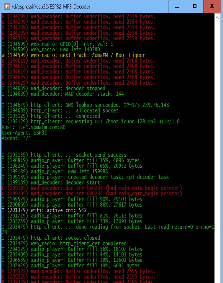

BuddyCasino, apologies if this is a digression from the current discussions, but you had mentioned potential optimizations for the case where there is a high latency connection. I am using a 4G hotspot at home for my internet connection and normally have no buffering issues with standard def youtube videos.
But I have consistent buffer underflow problems running the webradio. If I switch to the next radio channel, it starts up again, but within a few seconds, the buffer underflow issue starts again. See attached monitor screenshot which captures this scenario.
Am a noob when it comes to this area, but any chance you can let me know where to look and what tweaks might help with this ?
Hardware set up is an Easykit ESP32-B1 (Chip Rev 0 ) connected to a "DIY More" PCM5102A module. The only modification i made to your code was to configure the I2S signals on different pins for a shortest-path connection to the PCM5102 board. Stereo audio quality is quite good on headphones.

Yeah I've got a feeling this used to work better. Try:
- check freertos task priorities
- check wifi connection quality (RSSI)
You can increase the network buffer if you don't care about AAC.

Hi BuddyCasino, I tried tweaking task priorities, increasing dummy spiram fifo size, increasing the number of Wifi RX buffers etc. None of them worked, but the following trial and error hack seems to have mitigated the buffer under flow problem for me :
\audio_player\audio_player.c
uint8_t fill_level = (bytes_in_buf * 100) / spiRamFifoLen();
// seems 4k is enough to prevent initial buffer underflow
// me : 20% of 32k = 6k, comment needs fixing ?
uint8_t min_fill_lvl = player->buffer_pref == BUF_PREF_FAST ? 20 : 90;
bool enough_buffer = fill_level > min_fill_lvl;
//bool early_start = (bytes_in_buf > 1028 && player->media_stream->eof);
bool early_start = ((bytes_in_buf > (3*1028)) && player->media_stream->eof);
if (player->decoder_status != RUNNING && (enough_buffer || early_start)) {
Doubling the value of early_start seemed to have worked, but after a few minutes, could detect some stuttering. Tripling it was even better. Can now run several minutes without any choppiness, and any stuttering goes away within a few seconds. Before, it would never recover once the buffer underflow started.
I did find something that I thought may be inconsistent in \fifo\spiram_fifo.c. The fifo lowmark (112*1024) is defined as a value larger than the fifo size (32000). I modified it to be half of the fifo size (not sure what is appropriate). Though just this change alone without the change to audio_player.c did not fix the buffer underflow issue.
//#define FIFO_LOWMARK (112*1024)
#define FIFO_LOWMARK (16*1024)
#ifdef FAKE_SPI_BUFF
//Re-define a bunch of things so we use the internal buffer
#undef SPIRAMSIZE
//allocate enough for about one mp3 frame
//#define SPIRAMSIZE 1850
#define SPIRAMSIZE 32000
static char fakespiram[SPIRAMSIZE];
