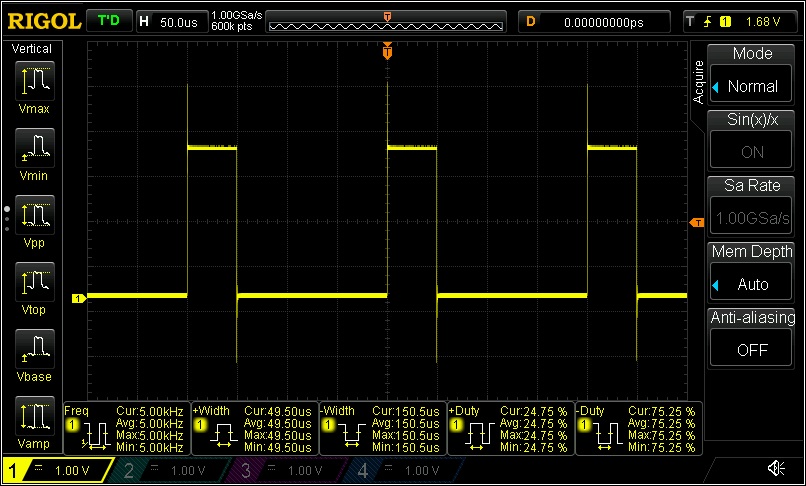

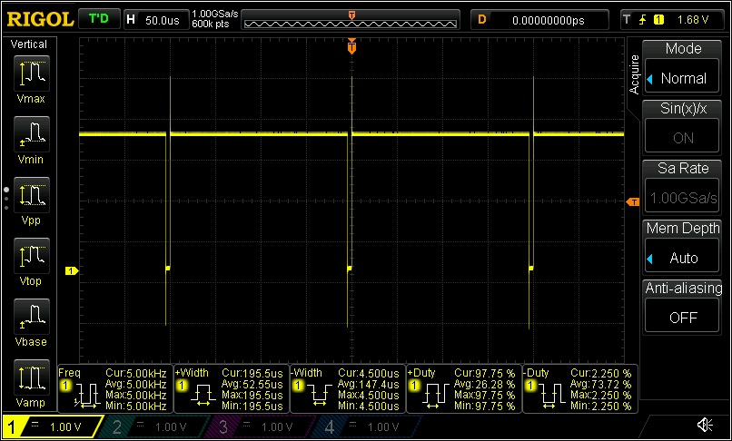

first part of code
Menuconfig ESP32 specific: 80 MHz
second part of code
hope this helps
