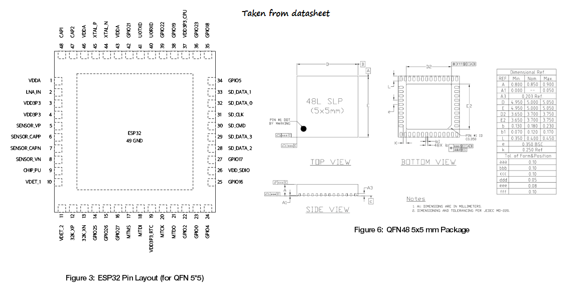

The pin 1 dot wouldn't line up with pin 1 if it was on the 14 pin side...
Cheers

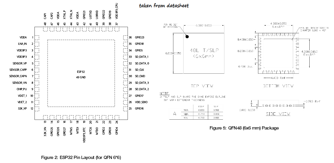

hi hans
you have the ESP32-D2WD Q5 too ?
i know, the skizze in the docu point with pin1 to the 14 side
but then one of the diagram is wrong cause like you see
Q6
Q5
in the Q5 must then a mistake in the datasheet, or not?

Exactly, it seems the QFN 5x5 has a mistake in the datasheet. The mechanical drawing matches the physical part, so that would mean pin 1-10 are where the current pinout drawing has pins 11-20. Can someone from Espressif confirm?

So either pin 1 is on the 10-pin side and numbering is clockwise or pin 1 is on the 14-pin side and numbering is anticlockwise? Numbering shown from (rotated) bottom view by mistake?
Re: ESP32 Pin Layout (for QFN 5*5), Pin25, Pin26
Posted: Fri Mar 31, 2017 1:25 am
by iosixllc
Numbering is always counter-clockwise, so I think we have to assume the pinout diagram is off by 90 degrees...

Thanks. Can you confirm my interpretation is correct, ie. pins are counter-clockwise and start on the long side?
Posted: Fri Mar 31, 2017 9:48 am
by ESP_igrr
Yes, pin 1 is on a 14 pin side, numbering is counter clockwise (if looking from the top).

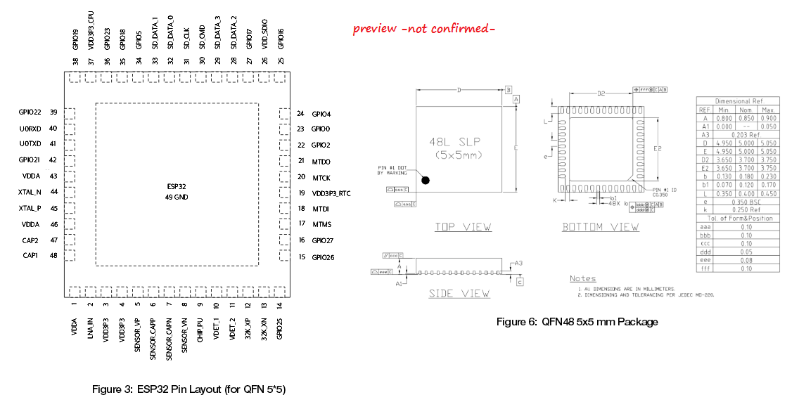

Posted: Fri Mar 31, 2017 11:53 am
by rudi ;-)
preview - not confirmed - wait for confirm
please check it.

Posted: Thu Apr 06, 2017 12:52 am
by ajaymm58
How long of a wait ? Need this info to finalize PCB design
