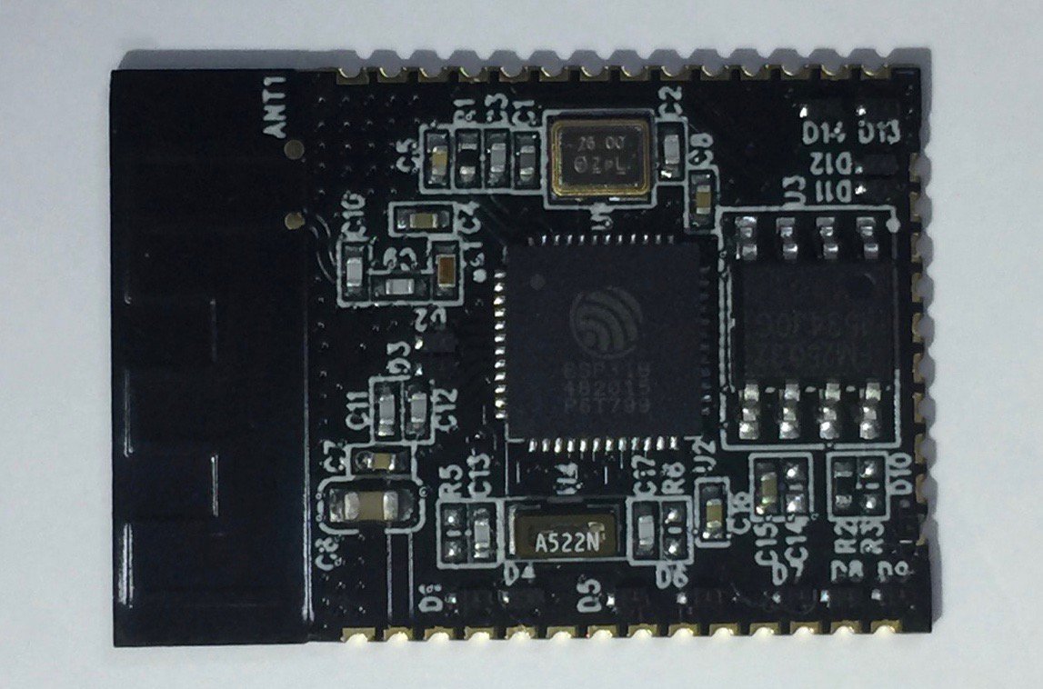

An internal prototype ESP32 board. Photo courtesy of Espressif System

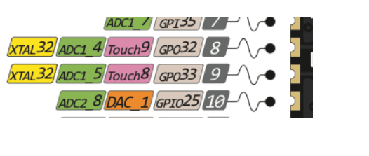

New version! 1.3

hi Alberto
txs,
can u say, which base you take, mean you with
GPI only direction is Input ?
GPO only direction is Output ?
GPIO direction is In and Output ?
Example Rev 1.3:
( GPO32, GPO33 , GPI35 ..)
Please have a look here:
* @brief Enable GPIO pin intput,This function only config GPIO0-GPIO31.
* @param gpio_bits : The GPIO bit number.
* @return null
#define GPIO_AS_INPUT(gpio_bits) gpio_output_conf(0, 0, 0, gpio_bits)
* @brief Enable GPIO pin intput,This function only config GPIO32-GPIO39.
* @return null
#define GPIO_AS_INPUT_HIGH(gpio_bits) gpio_output_conf_high(0, 0, 0, gpio_bits)
* @brief Enable GPIO pin output,This function only config GPIO0-GPIO31.
* @return null
#define GPIO_AS_OUTPUT(gpio_bits) gpio_output_conf(0, 0, gpio_bits, 0)
* @brief Enable GPIO pin output,This function only config GPIO32-GPIO39.
* @return null
#define GPIO_AS_OUTPUT_HIGH(gpio_bits) gpio_output_conf_high(0, 0, gpio_bits, 0)
we have GPIO0 - GPIO39 In and Output
Input		GPIO0  - GPIO31
Output 		GPIO0  - GPIO31
Input High	GPIO32 - GPIO39
Output High	GPIO32 - GPIO39
found here:
https://github.com/espressif/ESP32_RTOS ... ude/gpio.h
btw
GPIO Pin 24, 28-31 are not defined / special
#define GPIO_Pin_22 (BIT(22)) /* Pin 22 selected */
#define GPIO_Pin_23 (BIT(23)) /* Pin 23 selected */
//#define GPIO_Pin_24 (BIT(24)) /* Pin 24 selected */
#define GPIO_Pin_25 (BIT(25)) /* Pin 25 selected */
#define GPIO_Pin_26 (BIT(26)) /* Pin 26 selected */
#define GPIO_Pin_27 (BIT(27)) /* Pin 27 selected */
//#define GPIO_Pin_28 (BIT(28)) /* Pin 28 selected */
//#define GPIO_Pin_29 (BIT(29)) /* Pin 29 selected */
//#define GPIO_Pin_30 (BIT(30)) /* Pin 30 selected */
//#define GPIO_Pin_31 (BIT(31)) /* Pin 31 selected */
#define GPIO_Pin_32 (BIT(0)) /* Pin 32 selected */
like your work, hope we get docu asap for clear fine
and you can update fine, which software you use for diagramm?
nice work!!

The ESP32 chip pinout. Is the chip mounted in ESP32 module.
