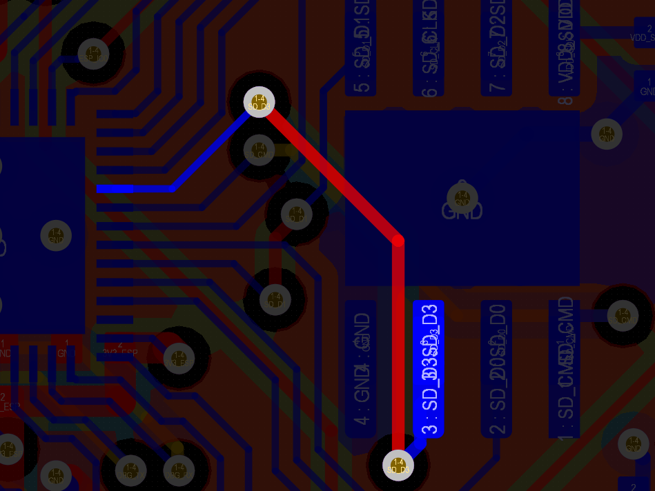

ESP32-D0WD Design Issue.

Postby esp_zag0 » Wed Jan 26, 2022 4:41 pm
Design snippet with WP highlighted for reference:

Re: ESP32-D0WD Design Issue.
Postby Sprite » Thu Jan 27, 2022 6:52 am
In general, you want to make your SCK line a bit longer than others... if you expect it's a trace length issue, what you could do is lower your SPI flash speed from 80MHz to something lower (20MHz), if it works then, you're looking at a timing problem.
Postby esp_zag0 » Fri Jan 28, 2022 1:29 am
Hi ESP_Sprite!
I tried lowering the speed to 40 and 20 MHz but that didn't make any difference.
However, I tried using more of these flash chips and it turns out some of my conclusions were wrong:
When using Macronix MX25R3235FM2IH0 I can only get it to work in DIO, both for first and second stage bootloader.
But both Gigadevice GD25LQ32DSIGR or ISSI IS25WP032D-JBLE work fine when using QIO in 2nd stage bootloader and QOUT (or DIO) in first stage. If I flash with --flash_mode qio I get this:
ets Jul 29 2019 12:21:46
configsip: 0, SPIWP:0xee
mode:QIO, clock div:1
load:0x3fff0030,len:5560
load:0xffffffff,len:-1
Any idea why Macronix refuses to use anything other then DIO? And why can't I use QIO with GD and ISSI for 1st stage bootloader? Should I even bother with it, ie. what kind of improvement will I get from it?
