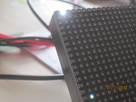

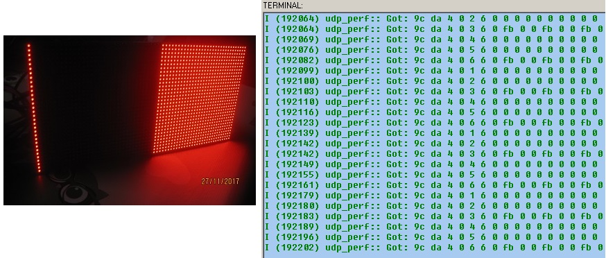

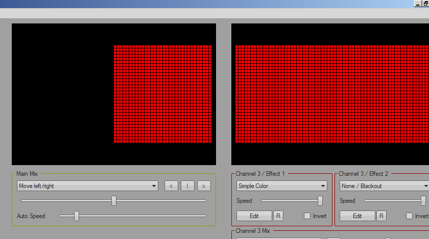

- The frame display mechanism has a few issues - the left most (zero) pixel seems to be wrapped from the right hand side of the display (should be easy to fix) and there are some ghosting issues especially with green (not sure where this is coming from)
Certainly needs some work but shows the capabilities of the chip and a cheap display.

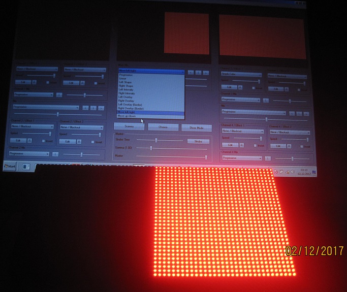

interesting
with JINX! with "Simple color" and Main Mix "Move left right"
the found can be pretty watch what you describe
( protokol on right side )
btw
a short test with my frame test and with tmp2.net protokol is the same.
i use your tmp2.net server version with this for a test.
the pixel(0,0) comes on frame(1,0) and light on frame(1,15)
the cat animation runs pretty well with jeroen version, so i think, there is a (bit) custom work need in this server version.
perhabs an index mistake 0, 1
btw, i work with pascal ( Delphi )
Pixel(0,0) FF FF FF

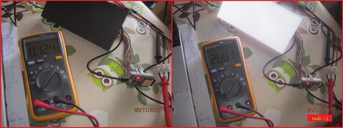

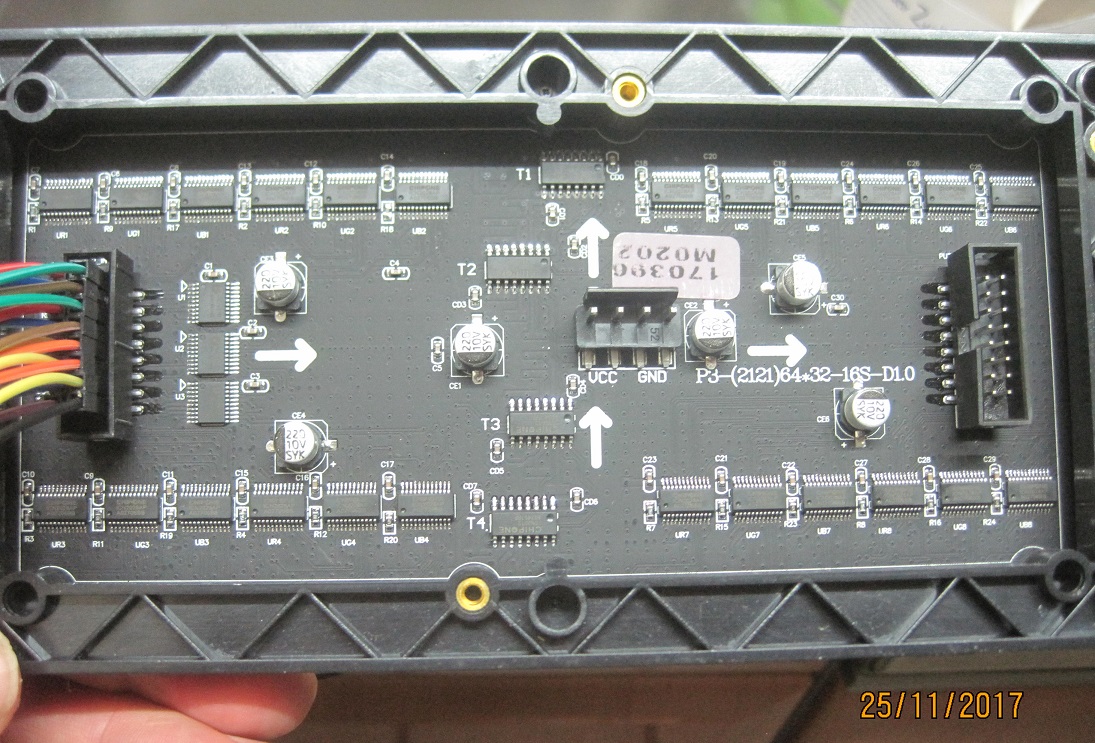

*info
i use this 64x32 p3 panel
P3-(2121)64*32-16S-D1.0
left side: 0,124 A ( 124mA ) save/sleep mode is R=00 G=00 B=00
right side: 2,601 (2601mA) full mode is R=FF G=FF B=FF

@wobblyboots
txs again. few hours after, i figured (indexing) it out now. all data fly to the right pixel, line, row, column :mrgreen:

here at this display it is 5V for VCC and GND
ESP32 drive the Panel, there are ICN2012, ICN2028A and SM245TS chips on the 64x32 RGB Frame
I use a 5V 3A power supply for this, cause my test
was with full white led's near 2,6 A, so i think it is enough for one panel.
hope this helps.

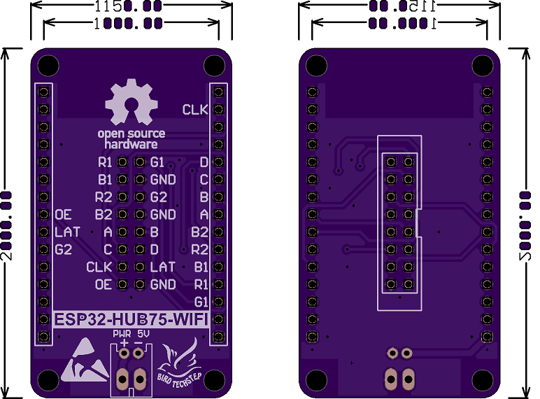

here is the first OSH project for this by BirdTechstep
