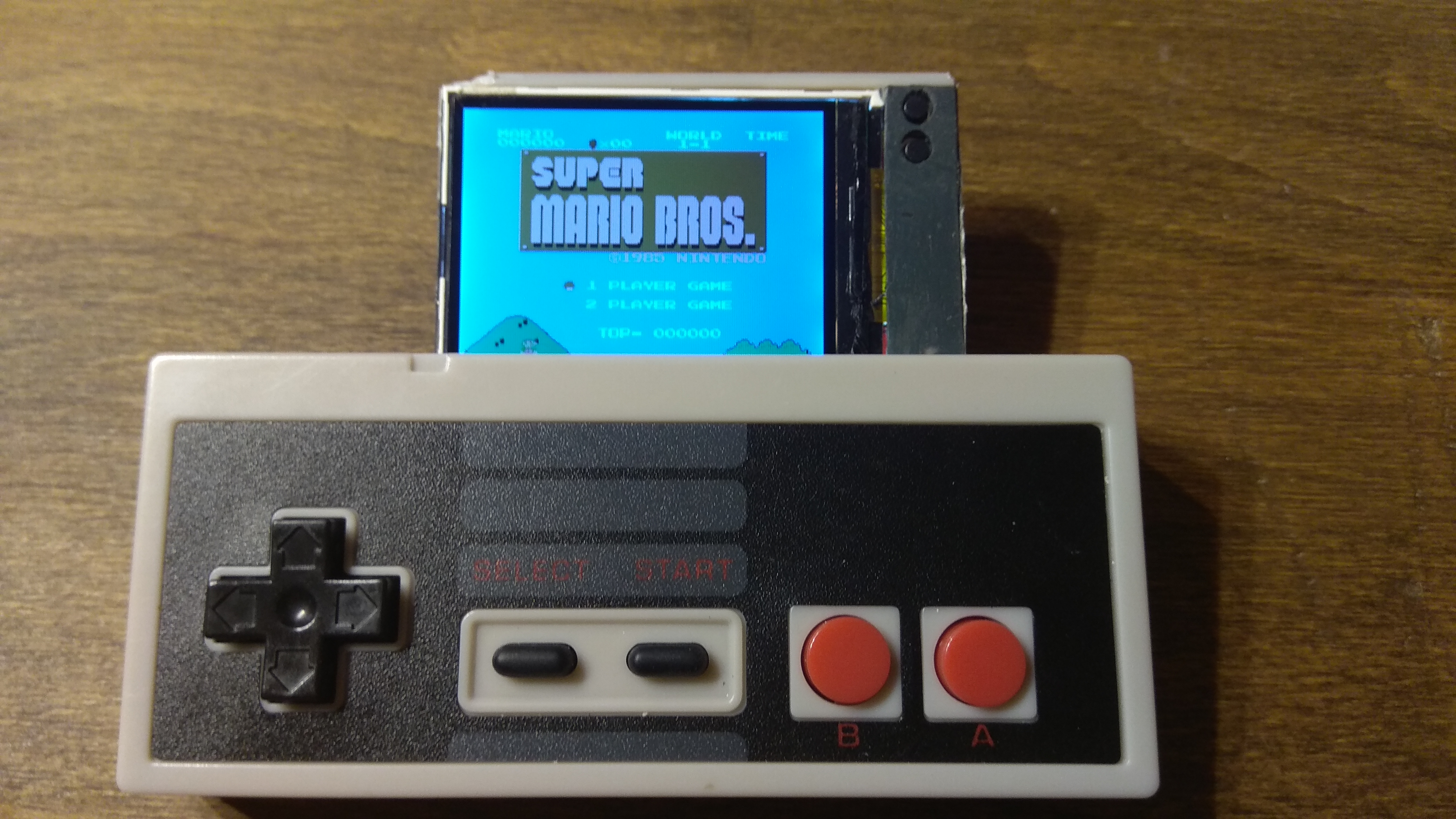

Maybe some of you are still interested...I made some slight changes.
https://youtu.be/sx6dCqX3idE
https://hackaday.io/project/160402-nespemu
Source Code can be found here:
https://github.com/MittisBootloop/esp32 ... _wemosmini
