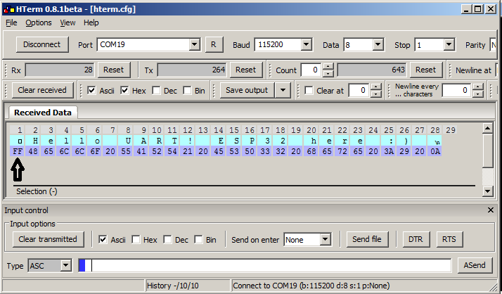

Ritesh, you can look into HardwareSerial.cpp as well and see what happens when you start arduino Serial :) it's pretty straight forward.
hi Me-no-dev,
ok - UART runs in IDF environment :)
btw:
void checkForData()
can we trigger this?
or do we must create a task for lookup?
txs!
( FYI )
on 115200 -is ur uart bitbang?- there is the first byte 0xFF then comes data
on 9600 the data are fine, but i will check all again
