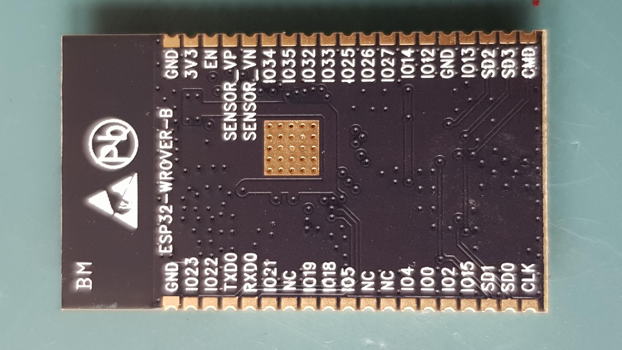

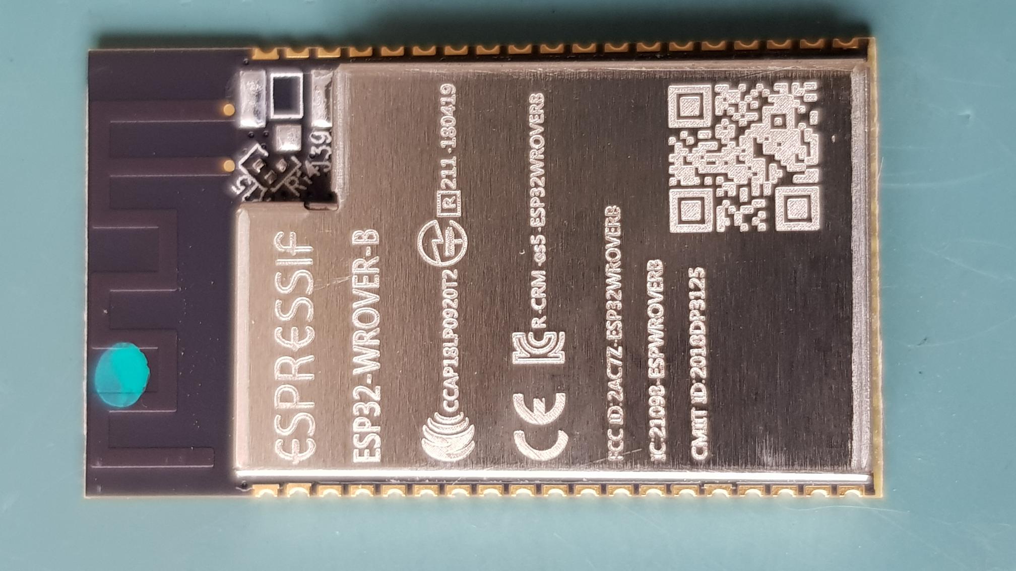

Re: encryption is working on one device not other
Posted: Mon Oct 08, 2018 11:34 am
by Grant.Bradley
The WROVER-B modules which we have from our distributor (Mouser) - actual photos:
WROVER-B front view
WROVER-B front view.jpg (239.5 KiB) Viewed 12066 times
WROVER-B back view
WROVER-B back view.jpg (218.37 KiB) Viewed 12066 times
Reading out the e-fuses on these wrover-b shows CODING_SCHEME = 1....

Flash voltage (VDD_SDIO) determined by GPIO12 on reset (High for 1.8V, Low/NC for 3.3V).
Posted: Mon Oct 08, 2018 8:58 pm
by WiFive
Yikes! Well there definitely needs to be fully documented and supported 3/4 coding scheme ASAP then.
Hopefully @ESP_Angus can answer: why does BLK3_PART_RESERVE auto select 3/4? How does the encryption engine handle the 192bit key? Will all 2 point Cal modules ship with this configuration? Is this an isolated batch and what are the dates/Mac ranges? how can we know when buying from a distributor what config we are getting (vref vs 2 pt)?
