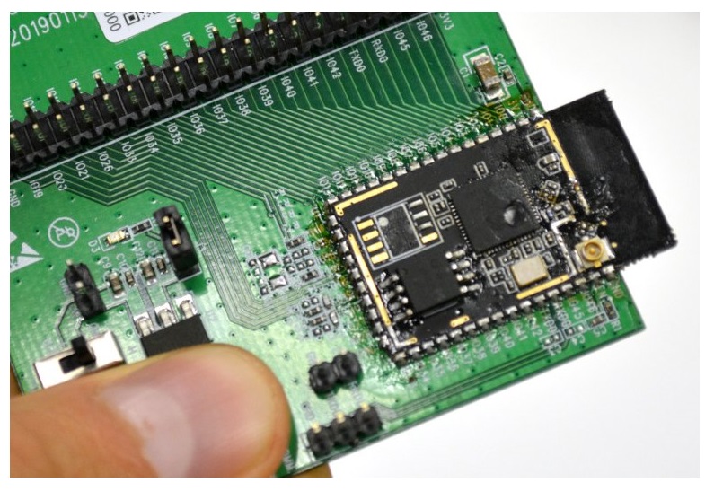

Postby rudi ;-) » Mon Mar 25, 2019 12:22 am
new pics in the wild:
click to see XXL size
found here

Sounds like it is basically "esp32+" or "esp33". I think we can mention small things that are hopefully fixed/upgraded from esp32 since it is not in production yet, there is still time!
- More psram cache address space
- More flash cache address space
- better ulp core (some tiny xtensa thing?, c targetable)
- minimal iomux conflicts
- better i2c peripheral, support clock stretching, slave address mask, monitor/debug mode
- support espnow and ble advertising from rom/ram only (wake stub, no flash load)
- BLE 5 phy features
- better continuity of reserved ram areas

Semiconductor development takes some time (the cost of fixing a bug is quite high!) The 7.2.2 chip in the photo that Rudi posted is pre-release silicon, not ready for anything yet apart from internal testing and development.
There will be an official announcement ASAP, though. Trust me, we want it to be ready just as much as you do. :)

A Announces is out from the pipe now - "Release of ESP32-S2 Secure Wi-Fi MCU, which is a highly integrated, low-power, 2.4 GHz Wi-Fi Microcontroller SoC supporting Wi-Fi HT40 and 43 GPIOs. Based on Xtensa® single-core 32-bit LX7 processor, ESP32-S2 can be clocked at up to 240 MHz"
there are few infos about features, CPU, Memorie (Xtensa® single-core 32-bit LX7 microcontroller, External SPIRAM (128 MB total) support, Up to 1 GB of external flash support .... ) Connectivity, IO Peripherals ( ..., Full speed USB OTG support..), Security , ..
POS machines and service robots (..., ESP32-S2 targets low-cost securely connected HMI devices, such as POS machines, ..)
Engineering Samples of ESP32-S2 beta will be available in June
