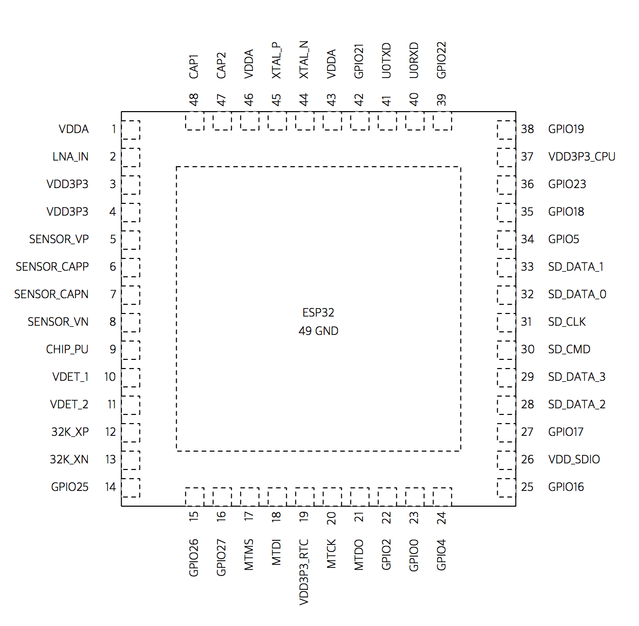

ESP32 Pin Layout (for QFN 5*5), Pin25, Pin26
Re: ESP32 Pin Layout (for QFN 5*5), Pin25, Pin26
This is the fixed pin layout diagram, it will be available in the next release of the datasheet.
OK, thank you very much for the fast response. This way round we have a confirmation that we have made the right assumptions a month ago and our design is OK as it is now.- We will send it out to the PCB manufacturer today.
This matches our PCB design as well, which is good because it's being assembled now.
