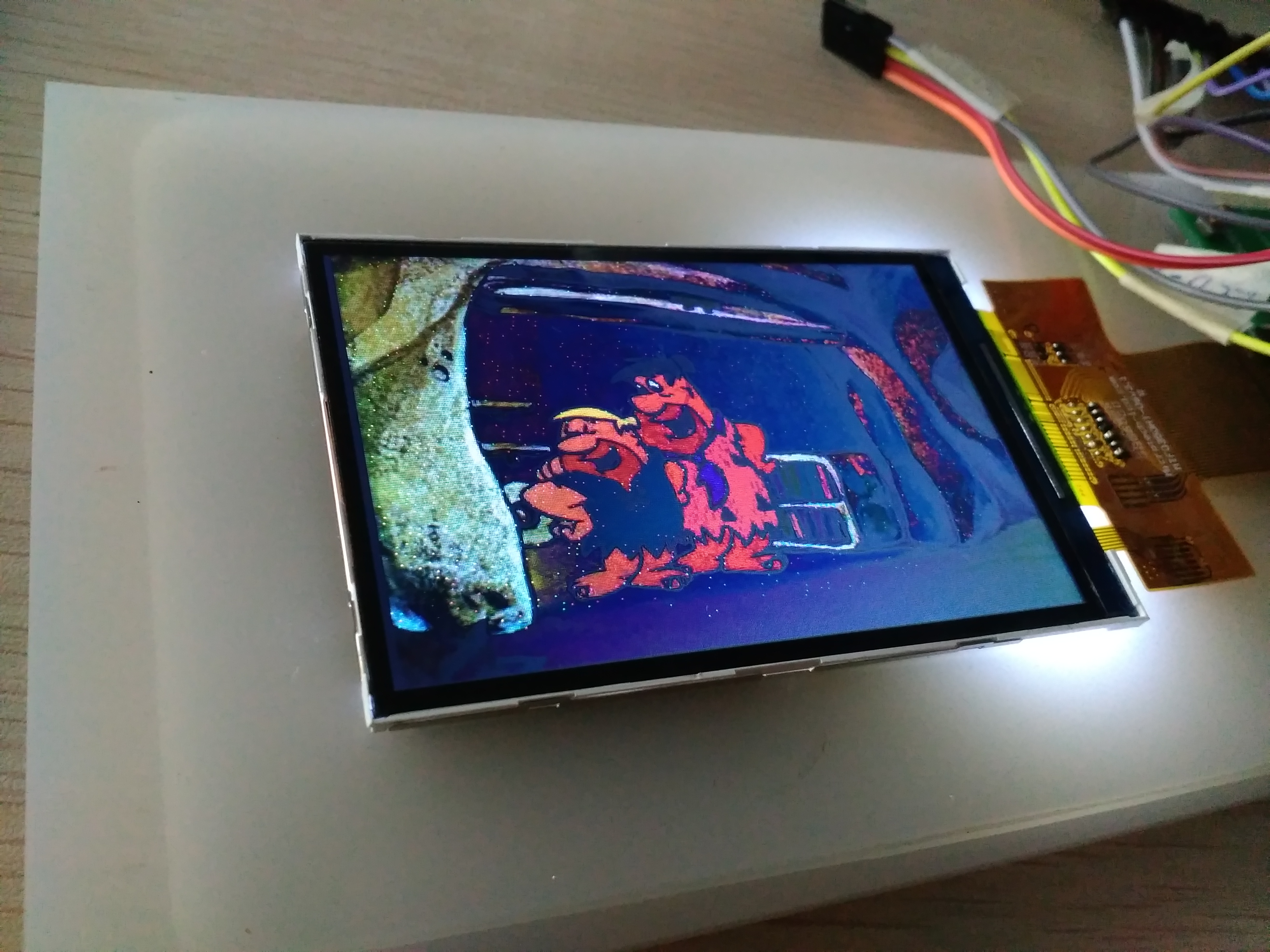

Please find attached image in which we are seeing some colored doted issues while displaying image into LCD9488 using your SPI NODMA example on ESP32 Development Kit.
Let me know if you find any clue or solution after looking attached image and also let me know if you need any information from my side as well.

Re: Need sample code for ILI9488 LCD on SPI Interface
Have you checked attached image which I have sent in last post?
Because, we are planning to drive display images on LCD and we are facing this white dots issue while displaying image.
Can you please look into this and let me know if you have any update for that
I've already answered that there is a bug in jpg decoding. I'll fix it soon, as well as couple of other bugs.Hi,
