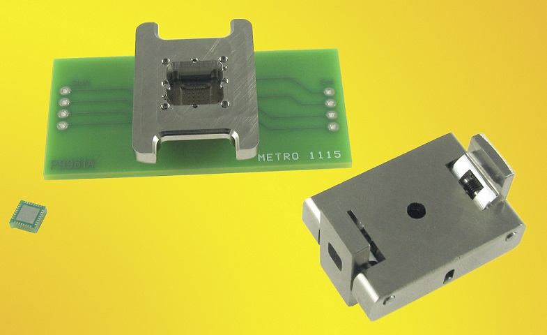

there are given nice test sockets for the QFN and i go on to do this on this way for first steps that we all flexible.
so it would be from interesst for the price for the test case, cause if pSRAM generall not possible on D2 then we know
and we do not build possibles on this test case here and save the money :)
so perhabs the question is greater, does we can use pSRAM on D2 generell.
if this just in time not knowed - no problem ( please feel free to make a short reply "not sure" then is ok )
with this test sockets
or this qfn(32) -> qfn(48) socket on pcb
or others
i am flexible - with an pcb it is static.

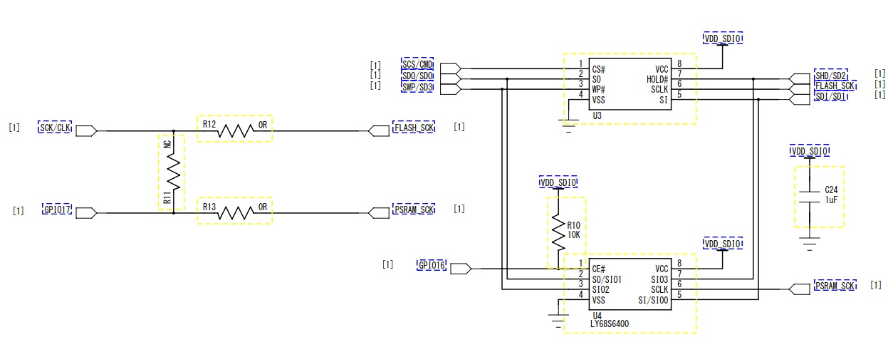

i have an espressif wrover modul with time stamp 502016 on the SOC and it is rev0
i wrote a simple firmware with testings and psram as spi ram for this and tested successfull.
FYI: i have the rev 1 too, and tested the same firmware successful, so i am sure, the fw ( code ) is ok
now we have a testmodul ( again soc rev 0 ) with lyonteks 32 MBit psram 1.8 and a 64 MBit flash.
the bootloader is booting and the first testings for test the flash is ok, it is the same code on firmware!
the SoC load the bootloader from SPI Flash well and start it
it wait now for user input for echo the inputs from the uart
we can communicate with it and to this "step" is all ok.
this let us know - the flash works - cause the soc can handle and read/save from and on the 64MBit flash

the next step is then to run the rest code and load the app code.
in this steps we test the psram

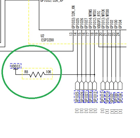

info: HDK
Bootstrap pin MTDI is pulled up to VDD33
SPI Flash share Data pins with PSRAM
PSRAM #CE is pulled up to VDD_SDIO and is connected to GPIO16
PSRAM SCK is connected to GPIO17
Q: why this exampe run on Wrover 32MBit_1.8/32MBit_1.8 modul ( SoC Rev 0 )
but not on the custom 64MBit_wide/32MBit_1.8 ( SoC Rev 0 )
Q: the 64MBit is wide flash ( 1.8 .. 3.6 V ) and works with 1.8 and 3.3 - is there a problem with 1.8 driven wide flash and combine 1.8 psram?
Q: we use Lyontek PSRAM, is there a magic key for psram ( ESP-PSRAM32 ) ID and if this not match the PSRAM is not supported?
Q: is there a hidden/not knowed detail on HDK that we not know? ( missing the edited wrover shematic file - can u post now ? )
Q: we need the HDK wrover shematic with BOM like the WROOM32 modul.
edit1:
and sure:
here is the shematic we use :
bootstrap pulled up:
flash and psram
now -
we need your shematic and info what we do wrong here.
edit2:
we work with cadence , eagle, kicad so there is no problem to import yours.
edit3:
FYI the name of PSRAM in Shematic is placeholder only ( it is named as 64 Mbit version )
we use 32MBit version on the Modul for the testings -
ESP_igrr
Posts: 2076
Re: ESP32 PSRAM support
Postby ESP_igrr » Wed Jul 05, 2017 8:28 am
Rudi,
Can you use idf-monitor (make monitor) when capturing log output? That tool will decode backtraces printed by the panic handler into source code file names and line numbers, which will make it easier to figure something out from the logs.
