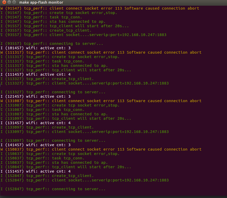

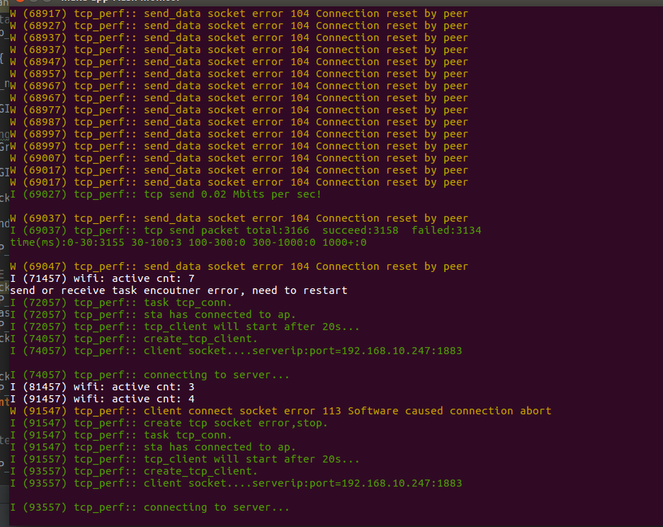

ESP_Iggr: Looks like a standard setup of a default mosquitto docker image, same as I have used.
I tried it again now, using the updated version of tcp_perf, commit fc85cb683d4a5e4c2a5b4cb7d607a3790b0cfb96. At first it looked to be working, but then the same thing happens again. Eventually it fails creating sockets, but I guess that is a programming error in the tool. See attached images (they are in reverse order, but I labeled them and you can see the time stamps).
Update:
I'm still getting this behavior consistently. Simply resetting the device allows it to successfully connect again, but it starts failing again after one or two disconnects. Also, I do not need to start/stop the mosquitto broker to provoke the problem; that was likely an observation-error on my part.
Update two:
If it matters, the network path is as follows: ESP32 -> Unifi AP-AC Pro -> Switch -> Broker.
Update:
Update two:

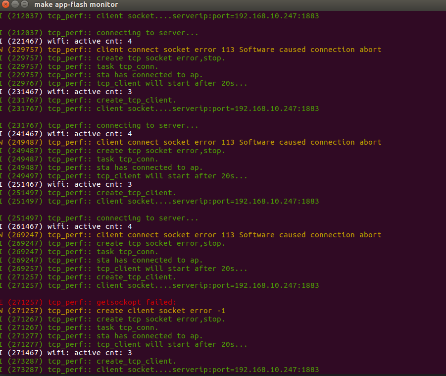

- Image 3: More failures.
- software abort3.PNG (136.98 KiB) Viewed 7431 times
- Image 2: Continues to fail
- software abort2.PNG (134.24 KiB) Viewed 7431 times
- Image 1: As you can see, it has succeeded in connecting but fails to send since the MQTT broker quickly realizes that it is sending something else than MQTT packets.
- software abort.PNG (159.79 KiB) Viewed 7431 times

Re: Socket issues
Status update. I think I've finally found the cause of the problem discussed in this thread - it has turned out to be a bug in the MQTT broker. After updating to mosquitto 1.4.14 (from 1.4.8) it is finally running stable.
