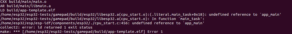

I have three source files in my project.

Can you post the exact error message being produced? Maybe try the make after setting the environment variable "V=1" to get more verbosity. Can you also paste-bin your main source file. It might be useful to have a fresh pair of eyes on the "app_main" declaration.
Re: Programming in C++
LD build/wifi_button.elf
C:/esp32_projects/esp32_wifi/build/esp32\libesp32.a(cpu_start.o):(.literal.main_task+0x20): undefined reference to `app_main'
C:/esp32_projects/esp32_wifi/build/esp32\libesp32.a(cpu_start.o): In function `main_task':
C:/esp-idf-v3.0-rc1/components/esp32/cpu_start.c:452: undefined reference to `app_main'
collect2.exe: error: ld returned 1 exit status
make: *** [c:/esp-idf-v3.0-rc1/make/project.mk:387: /c/esp32_projects/esp32_wifi/build/wifi_button.elf] Error 1
https://pastebin.com/YvuCp4d7

Hmmm .... well I'm puzzled. The "nm" command is showing a definition for a C function called "app_main" in the library as one would hope. Your C file looks good. However your report say that the linkage can't find "app_main". Thinking this through, what might remain is the notion that "somehow" your compilation is simply not including libmain.a. We might be able to determine that by your deleting build and then doing a build with an export of "V=1" and capturing the results and paste-bining them. That will show which files are being link-edited together to produce the resulting final binary. The reported story would be consistent with compiling main.cpp, adding it to the library but not including the library in the linkage.
I am able to recrete similar error, but obviously its not you case, by removing extern "C" from main.cpp.
