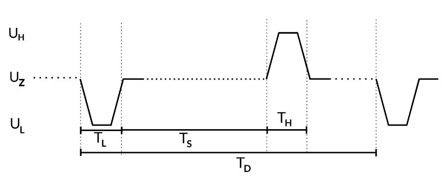

@ok-home I have problem to decode other signal, this time the signal with higher variable.
It mention in this document: https://github.com/iblue/mhi-xy-bus/blo ... report.pdf
The frame is 48 bytes long, using hbs standard, the signal mention below
With RMT driver it can only decode some frame, most of the time show error.
This is HBS base but MHI encode difference way. Do you have any idea to make it stable.
For example the frame never include 0xFF signal, but with RMT driver and you github code, it show many times. I am using ESP32.
as far as I can see it's not hbs at all
frame size is at least
16 bytes * 3 characters * 2 rmt_symbol_word_t = 96 rmt_symbol_word_t
and I don't know how you define low and high pulse

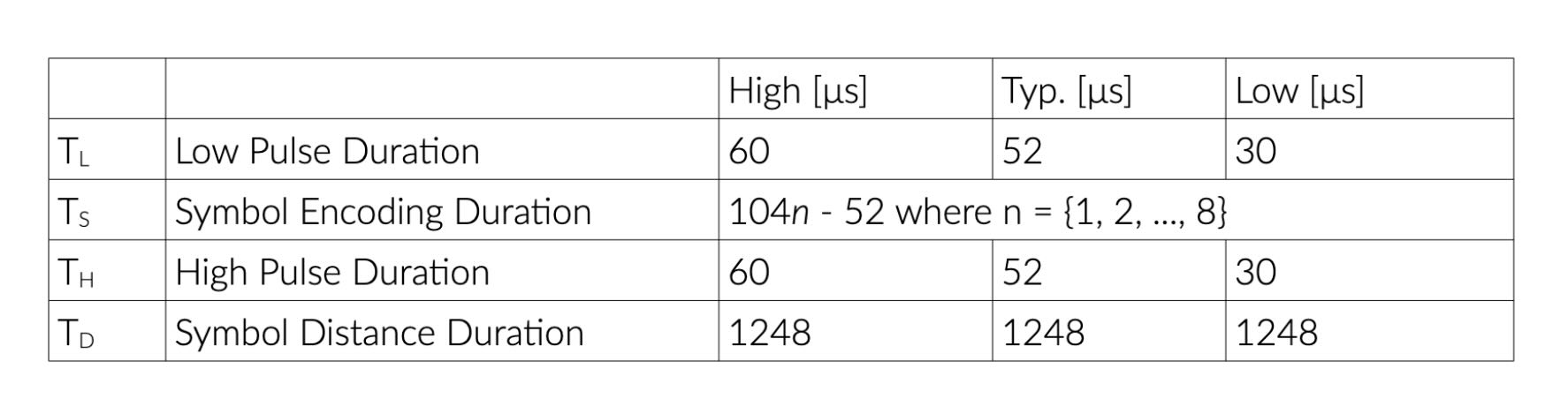

if you follow this protocol
it has nothing to do with HBS, it is easily implemented on rmt with encoding and decoding
the only question is how levels uh,uz,ul look like when input to rmt which has only 2 states "0" and "1".
The fact that it is somehow read by the receiver hbs does not mean that it should be used.
HBS - 22 BIT in message (01 - start, 00/01 - bit value, 00/01 - parity bit, 11 - stop bit) 8-bit+parity/19200 baud only
MHI - encoded by symbol encoding duration Ts, bounded by Tl and Th

This is based on the HBS protocol, which encodes 1 byte into 22 bits and transmits it over the bus. Please note that the PDF documentation may not be 100% accurate. The system uses the same hardware mentioned in this project: P1P2MQTT https://github.com/Arnold-n/P1P2MQTT
I have real hardware that includes a dedicated HBS encoder/decoder chip (the same one used in P1P2MQTT), along with an ESP32. The system encodes 48 bytes into 48 × 22 bits and sends them over the bus. It is working, but the error rate is quite high—most likely because I’m using only an ESP32. I am connect it to MHI system bus with an RC-E5 wall remote and the data tell the truth.
In contrast, the P1P2MQTT project uses two microcontrollers: an ATmega328 to decode the raw data (referred to as P1P2 serial) and an ESP8266 to handle data decoding and send it to MQTT. Their implementation appears stable and doesn’t exhibit the same issues.
My current problem is system stability. Converting 48 bytes into 16 bytes is straightforward and doesn’t require RMT. However, to convert raw binary data into 48 bytes, I’m using your RMT-based code, which is why I’m reaching out here.
