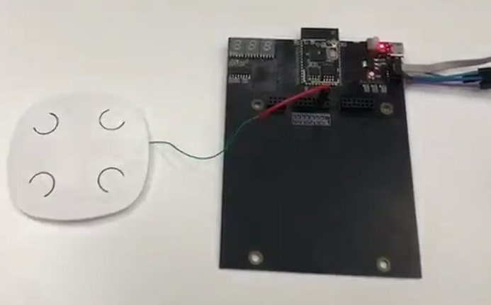

few things are spotted in the wild last hour's..
Engineering Board PIC taken from the ESP32-S2 demo 1 , also here
