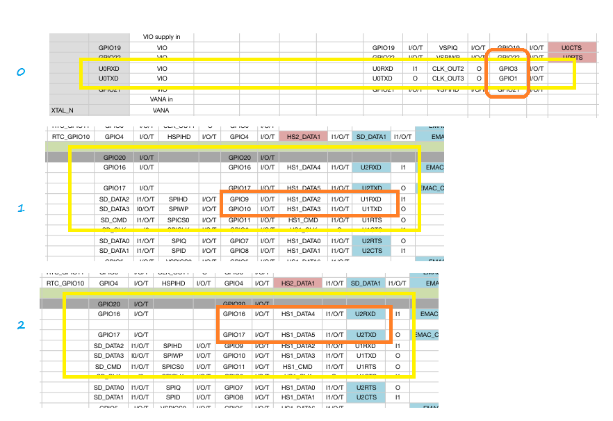

I tried to follow the steps to flash the ESP32-AT but seem doesn't work. I am quite confuse on the UART1 Tx and Rx pin number. Which pin number does it refer to? Is it the UART1 pin number on the ESP32 chipset?

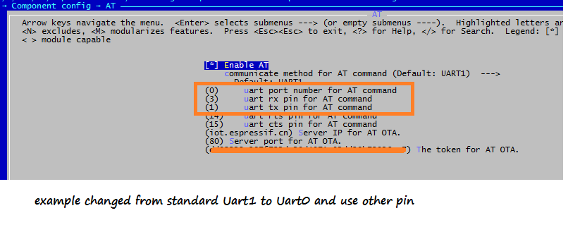

it work's fantastic
chaning from
UART1 Tx
UART1 Rx
to UART0 pin list are here
http://espressif.com/sites/default/file ... ist_en.pdf
short view: and you can use your own pins, that you have to select then in component config -> AT
hope this helps

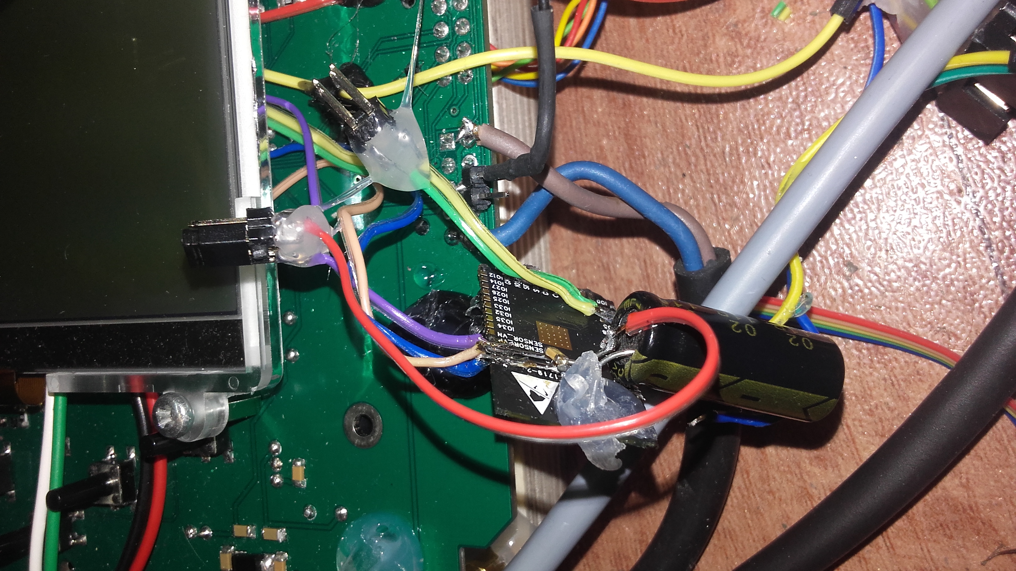

When I`m using the terminal, everything works better.
When I`m using the AVR couple of things dosen`t work properly.
Most times I`m loosing the reception. Can`t find SSID name of the station on my celphone and another ESP32 modules.
As soon as I make communication through the terminal, most things works better. I`ve added the low ESR capacitor of 3300uF and ceramic 100nF but it doesn`t fix the problems.
I enclousure the picture of soldered modules.

wind_energy
- Posts: 28
- Joined: Fri Feb 03, 2017 10:36 pm
Re: ESP-WROOM-32 AT commands firmware
I`ve changed the ground and 9600 baudrate - at the moment works brilliant

Hello Rudi! thank you very much for your help.
In my las post i wrote twice that i've used the uart1. Actually in the second time i used the uart0 just like you do it.
and also not works
Can you send me your bin files? to check if i am making some mistake at compilation or is another problem.
regards
After reading your answer, i tried using the same serial program with the same configuration that you use.Component Config -> AT (using a usb-serial adapter)
*uart port number for AT command = 0
*uart rx pin for AT command = 3
*uart tx pin for AT command = 1
and also not works
