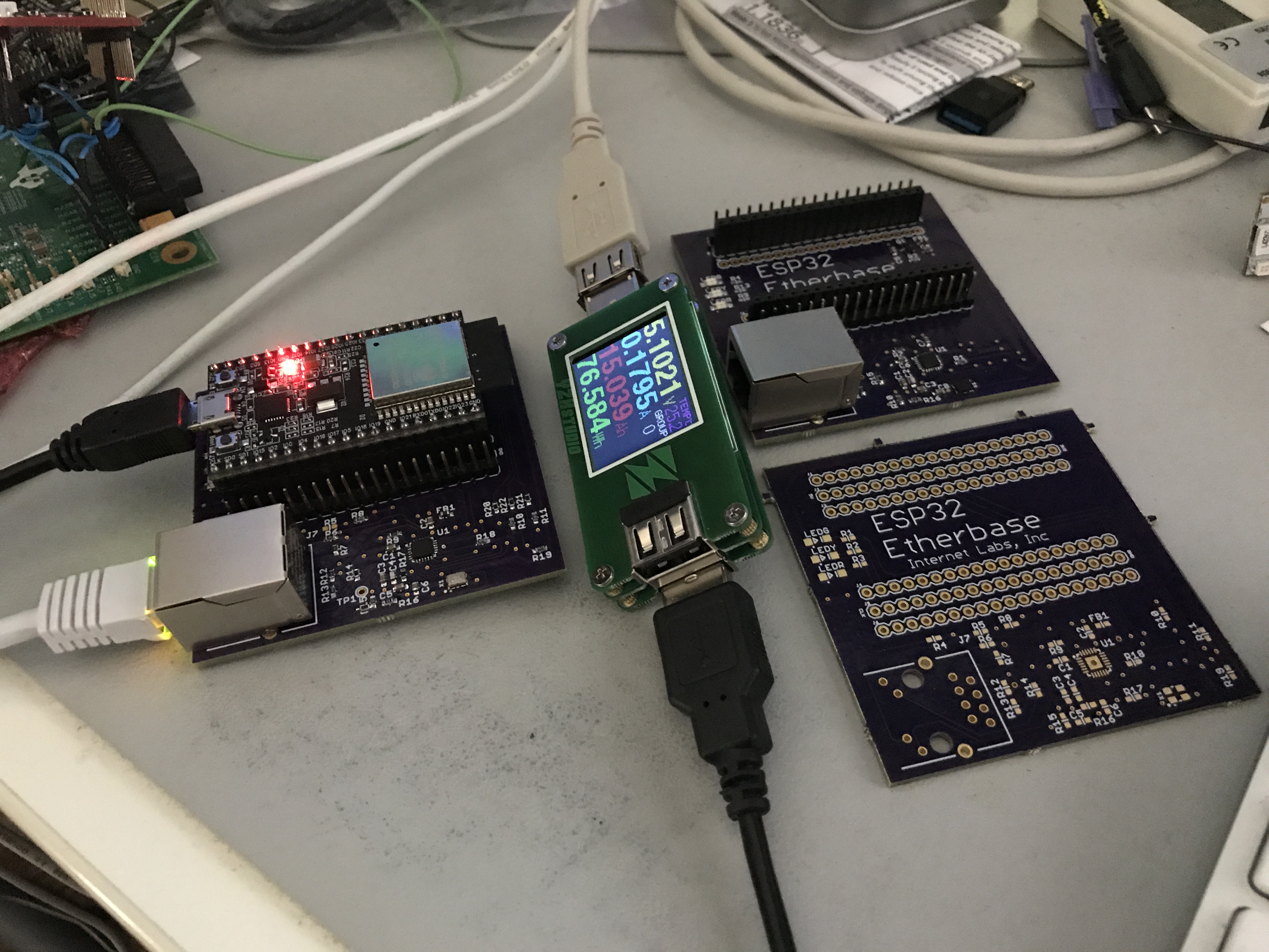

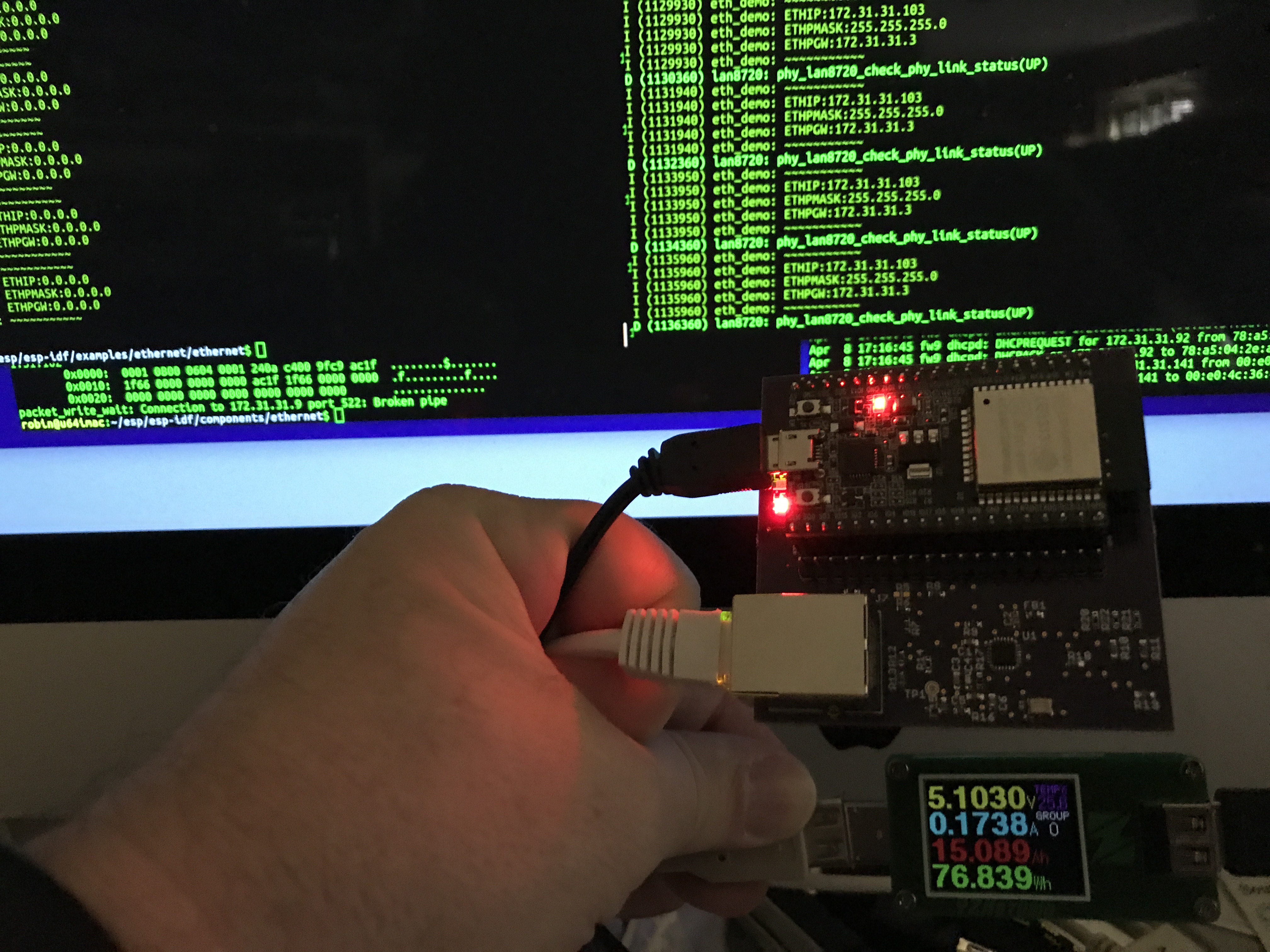

Postby RobinC » Sat Apr 08, 2017 9:22 pm
Made a little "ESP32 Etherbase" ethernet proto board for the devkit-c. Working well with the LAN8720A.
Robin

Re: EMAC receive not working
Postby RobinC » Tue Apr 11, 2017 2:26 pm
Yes, lan8720 with 50Mhz crystal. I use GPIO17 from the stock master tree used in phy_device_power_enable() to connect to the enable pin on the crystal. I also had to add a 100 ohm resister between the crystal and the ESP32 to prevent current drain that lowered the clock voltage.
Robin
