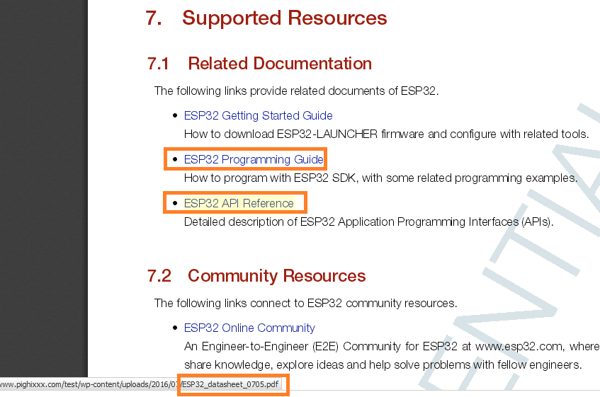

Re: [Documentation Release] ESP32 Hardware Resources
Postby pighixxx » Thu Jul 07, 2016 10:09 am
Posts: 1759
Postby rudi ;-) » Thu Jul 07, 2016 1:46 pm
Wow -
thats big effort work!
many many thanks - can't say - how happy now!
now its run here :mrgreen:
( nice data pdf - now we are up2date here more as online resource ) :mrgreen:
( FYI: the two links refer to the datasheet - have you the api /programming guid too? , thanks )
