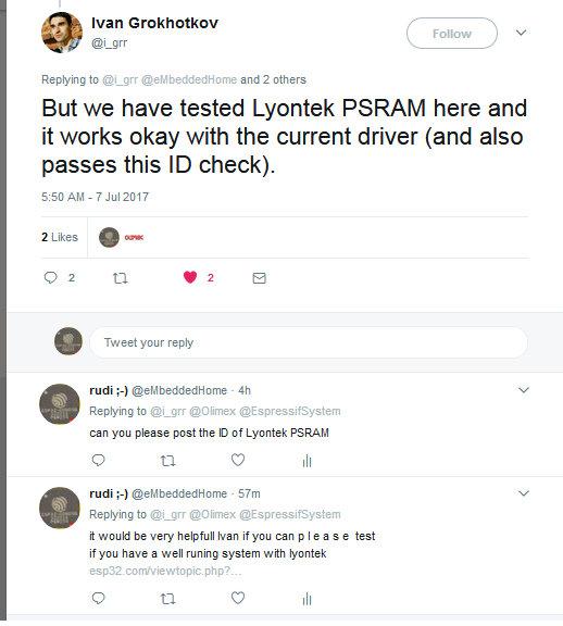

Hi guys,
as you know I've tried to get pSRAM working using Lyontek's modules.
Now I found this line in the ESP-IDF:
 if (((id >> PSRAM_MFG_ID_S) & PSRAM_MFG_ID_M) != PSRAM_MFG_ID_ESPRESSIF) {
 return ESP_FAIL;
Source: https://github.com/espressif/esp-idf/bl ... ram.c#L529
This might explain why it wasn't working.
I feel like Espressif must have been aware of this?
I'm willing to give you the benefit of the doubt, but please understand that I feel mislead.
Can you please clarify the situation?
Do you want to restrict the compatible modules for some reason that I'm not aware of?
I'd really appreciate your feedback here.

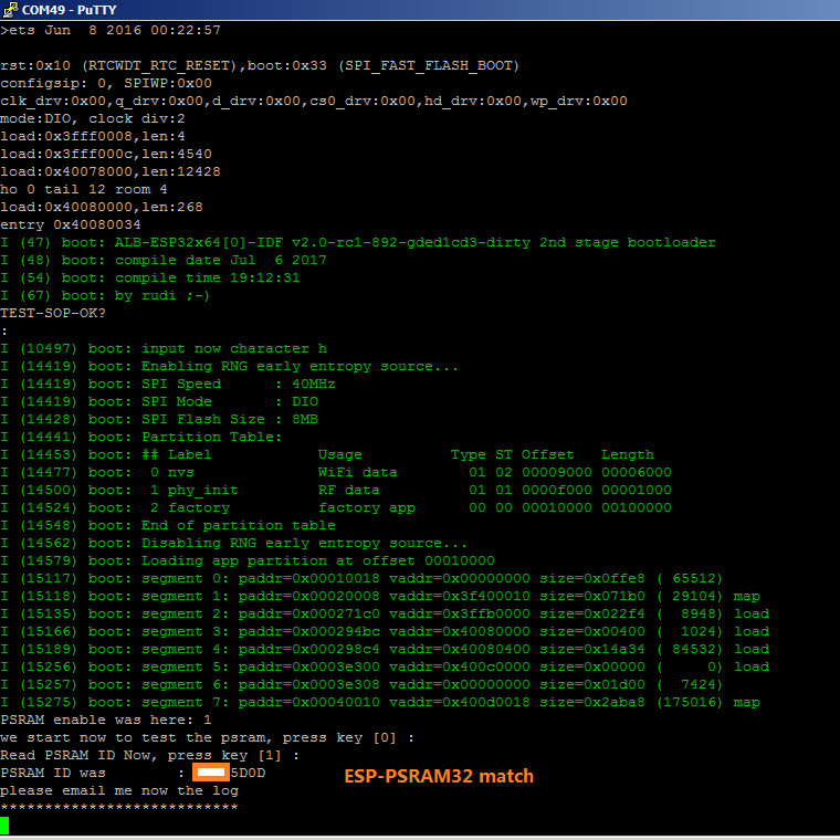

Log from my Special Bootloader Code with PSRAM Support
you see ESP-PSRAM32 Match ...
for (secure reason the first 2 byte i maked "black"
same firmware on lyontek:

PSRAM enable was here: 1
we start now to test the psram, press key [0] :

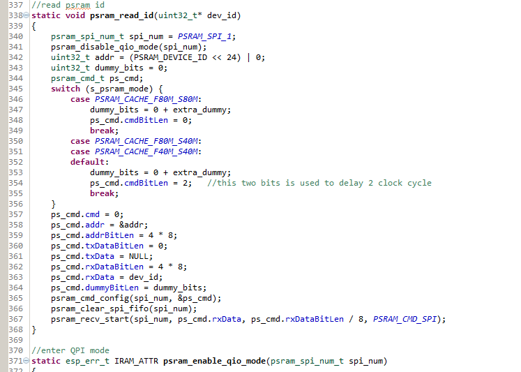

Read PSRAM ID Now, press key [1] :Guru Meditation Error of type IllegalInstruction occurred on core  0. Exception was unhandled.
Register dump:
PC      : 0x400d1b6d  PS      : 0x00060530  A0      : 0x80082599  A1      : 0x3ffe3be0
0x400d1b6d: psram_read_id at /mnt/Share/psram/esp-idf-psram/components/esp32/./psram.c:347
A2      : 0x3ffe3c30  A3      : 0x00000023  A4      : 0x00000004  A5      : 0x00000000
A6      : 0x00000000  A7      : 0xfffffffe  A8      : 0x00000001  A9      : 0x3ffe3b90
A10     : 0x00000001  A11     : 0x00000000  A12     : 0x00000034  A13     : 0x00000000
A14     : 0x00000000  A15     : 0x00000004  SAR     : 0x00000017  EXCCAUSE: 0x00000000
EXCVADDR: 0x00000000  LBEG    : 0x40094c1c  LEND    : 0x40094c4a  LCOUNT  : 0xffffffff
0x40094c1c: memset at /home/jeroen/esp8266/esp32/newlib_xtensa-2.2.0-bin/newlib_xtensa-2.2.0/xtensa-esp32-elf/newlib/libc/machine/xtensa/../../../../.././newlib/libc/machine/xtensa/memset.S:127
0x40094c4a: memset at /home/jeroen/esp8266/esp32/newlib_xtensa-2.2.0-bin/newlib_xtensa-2.2.0/xtensa-esp32-elf/newlib/libc/machine/xtensa/../../../../.././newlib/libc/machine/xtensa/memset.S:171
Backtrace: 0x400d1b6d:0x3ffe3be0 0x40082599:0x3ffe3c30 0x40080f62:0x3ffe3c60 0x40078861:0x3ffe3ca0 0x40078a88:0x3ffe3cd0 0x40079160:0x3ffe3d50 0x40080109:0x3ffe3e70 0x40007c34:0x3ffe3eb0 0x40000740:0x3ffe3f20
0x40082599: esp_restart_noos at /mnt/Share/psram/esp-idf-psram/components/esp32/./system_api.c:338
0x40080f62: call_start_cpu0 at /mnt/Share/psram/esp-idf-psram/components/esp32/./cpu_start.c:200 (discriminator 1)
0x40080109: _WindowOverflow12 at ??:?
Rebooting...

I'm willing to give you an answer on this, but after the last fiasco, I want to be very very clear about one thing: Officially, we do NOT support any other chip than the ESP32 PSRAM. This means that officially we do NOT give out ANY support for this chip, at least not on this forum. That also means that any support you DO get is entirely given out of goodwill of the engineers hanging around this forum, not fact-checked, and can be wrong in any or all aspects. It also means that if you put this into a design and it doesn't work, it's not our problem.
Okay, with that said: the psram ID check is not the problem here. The bits of the ID that the code checks happens to be the same between the Lyontek PSRAM and the ESP32-PSRAM chip. Feel free to put a ets_printf when the check fails: you will not see it in the output.
I actually retrieved one of the Lyontek chips (didn't knew we had those) and reworked one of my ESP_Wrover_kit modules to take that instead of the module that was on there. With flash and PSRAM clocked at 40MHz, I have no problems and a stably-running Doom, and that is with the public psram esp-idf tree and Doom sources. With the flash running at 80MHz, the chip was less stable, it crashed within a few seconds where an ESP32-PSRAM would at the very least run for much longer.

ok thank you -
jeroen you tested on wrover kit on wrover modul with orig spi flash and lyontek psram successfull doom?
can you confirm this ( perhabs i missunderstand english )
can you say which SoC Rev you used on this?
can it be, that ESP-PSRAM32 works with Rev0 ( like in this demo )
and Lyontek not?

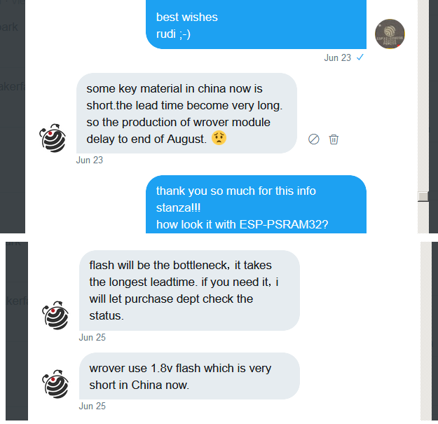

That Espressif at the earliest end August / Mid September (according to their information) again SoC Rev1 has available.
edit:
the wrover modul is also earliest available end of augus/ mid september then here
the psram are also not available, earliest end of august/ mid september
( sales " Eacen", and espressif itself )

can you please -unofficially- run onetimes my firmware on your HW and post the LOG?
this firmware runs well on
ESP32 Wrover Rev0
ESP32 Wrover Rev1 on Wrover Kit V3
same FW runs not on a
Custom Board with the shematic i posted
and PSRAM from lyontek and wideflash
thank you.
simple flash it like it is to 0x0
( it is only named as zip for the upload )
TESTCASE1.bin.zip
edit:
:cry: I didn't hear about those dates yet.
edit:

hi ivan
i saw your postings on twitter -
nice, feel free decent to help further us with an test with this firmware i posted
and please post the log -
if there is all ok with your saying in the tweet about ID check pass then this must run on yours with Lyontek psram too
that the firmware is ok says
- runs on wrover rev0 with ESP-PSRAM32
- runs on wrover rev1 with ESP-PSRAM32
- runs on wrover rev0 with ESP-PSRAM32 on wrover kit v2
- runs on wrover rev1 with ESP-PSRAM32 on wrover kit v3
so -
i think the firmware is not the problem
thank you for your support

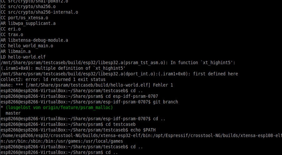

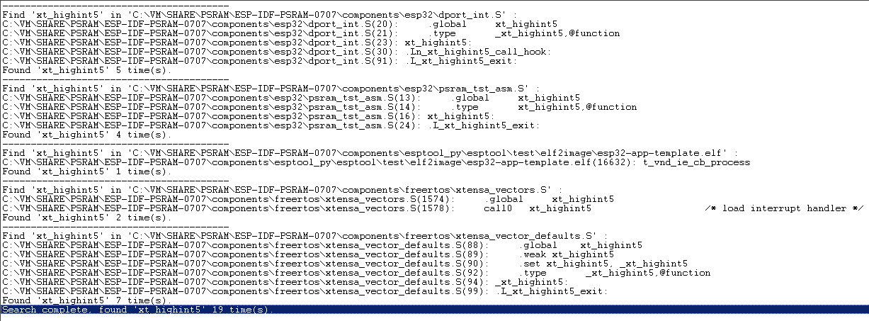

now the same here :
new download on psram future..
the thing do not more compile now:
found more times 1.png (102.6 KiB) Viewed 21877 times
found more times.png (45.93 KiB) Viewed 21877 times
