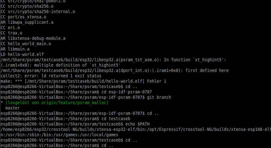

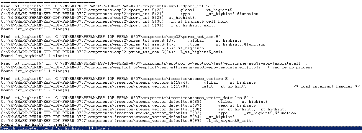

now the same here :
new download on psram future..
the thing do not more compile now:
found more times 1.png (102.6 KiB) Viewed 21924 times
found more times.png (45.93 KiB) Viewed 21924 times
so if you want history why there is something things run and not
save all things separatly -
i switch to my runing psram future back..
the doom example was the same example -
only after there was a "hey it does not run"
the finnish comes for a run...
why allways make a l l public?
...it is enough there is a code line ...that the user can see
it is not important that this run...the people have no psram .. and so on..
it is salami tactic not more.
