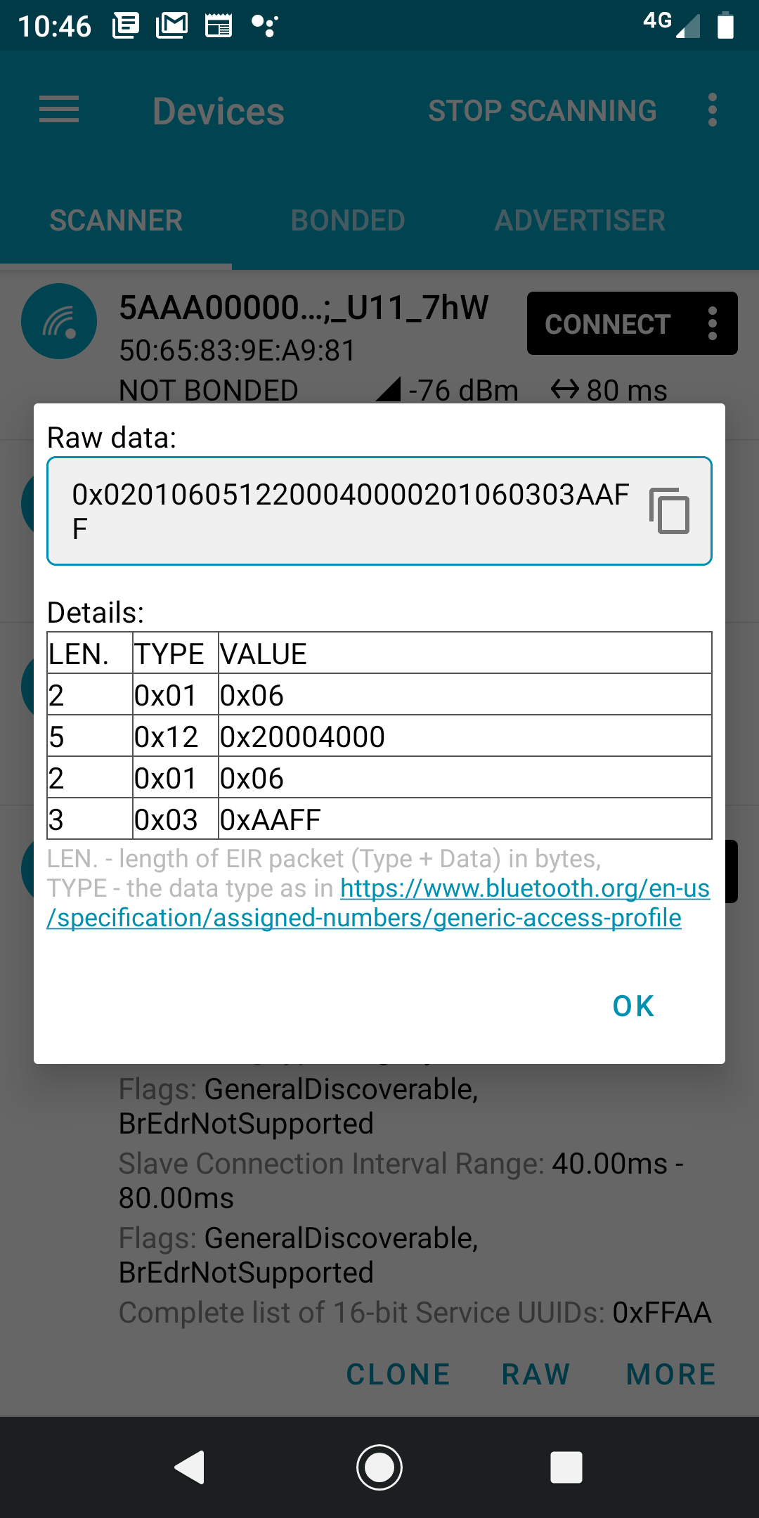

I'm facing the reboot issue in Arduino when using Wi-Fi and BLE together. I integrated the Wi-Fi, EEPROM, and GPIO activities first, which worked fine. Next when trying to wite an Eddystone beacon, along with Wi-Fi, EEPROM and few GPIO activities, after I added BLEDevice, I faced Sketch too big issue. After I changed the default partition to increase the program memory area, also tried selecting partition scheme "No Ota (Large APP)", the issue gets solved.
Now the issue is with the Eddystone advertisement. The beacon is advertising something else, though the debug log says the advertisement data set is completed. Attached is a snapshot of raw advertisement data captured using nRF Connect.

02 01 06 03 03 AA FE 15 16 AA FE 10 00 03 62 69 74 2E 6C 79 2F 42 72 69 7A 6F 36 34 61 FF
Service Data set!
