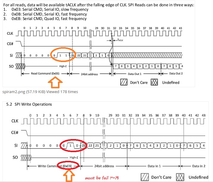

the data and table and info you give here for pSRAM
is wrong like you can see, copy paste mistake?
no info 1.8 or 3.3
no info SPI mode what to do with /WP /HOLD
no simply "hello world" check code for corect connect
1/2 year guys!!
so bad.
simple spi driven things not give the response.

Postby rudi ;-) » Fri May 19, 2017 12:43 pm
(If you want an example, we gave out some early psram samples and I gave out some screenshots from an early datasheet of the chip... and here we are...)
the screenprint does show 0x03 for write and does show 0x03 for read,
but the table looks difference. perhabs you check this
if you can check the testing code, ( more we can not test cause we have no info what we must do )
so you can edit to run a simple
-> write
-> read
-> READ_ID
here is my help to you if you are not start this
you can edit by your knowledge to start here
it is a simple SPI Master code
taken from the esp-idf repo
and edit for using it with pSRAM
and i am sure - there are many mistakes
in it - but we do not know more -
/WP
/HOLD
Were connected to presumption
Whether it is correct - no idea
I have no data sheet of the "manufacturer" available - but you Jeroen.
Simple task to write and read fails
- there must be wrong info about CMD
- there must be wrong info about connect
- there must be wrong / bug in rev 0 silicon? ( i think not so cause rigol response some things right way )
- CLK is 10MHz - so SPI read write must be work ( support is do 33 )
we play now 14 days on this without a result
