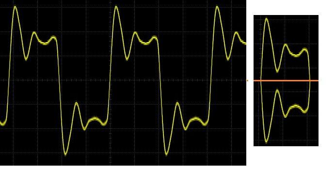

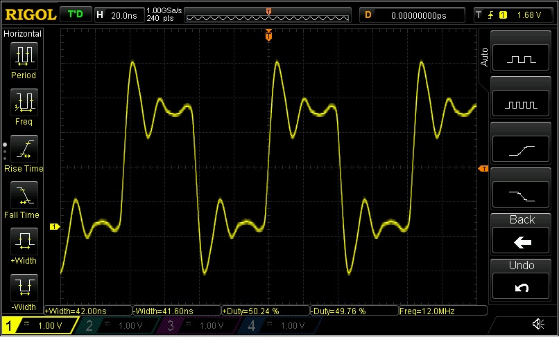

Anyone try with 12mhz apll clock? How is jitter?
Posts: 1759
Re: ESP32 Webradio
Postby rudi ;-) » Fri Mar 03, 2017 2:06 am
Hi WiFive
1,2,8
12MHz
WiFive
Posts: 3529
Re: ESP32 Webradio
Postby WiFive » Fri Mar 03, 2017 2:28 am
Hmm I see.. and resulting jitter on i2s_bck ?
Posts: 1759
Re: ESP32 Webradio
Postby rudi ;-) » Fri Mar 03, 2017 2:39 am
asap WiFive (not today) , i am on other place now.
do you see, allways the same buzzy waves, on pos and neg ( inverted )
edit: Like a pattern, watermark noise ;-)
edit: add a play on pic ( cut and paste the pos and neg )
with 32.5 MHz is comming a "compensation".
WiFive
Posts: 3529
Re: ESP32 Webradio
Postby WiFive » Fri Mar 03, 2017 3:06 am
Yes but we care about edges and how digital bck compares to jitter from bpll src https://esp32.com/viewtopic.php?f=17&t= ... t=20#p4727
