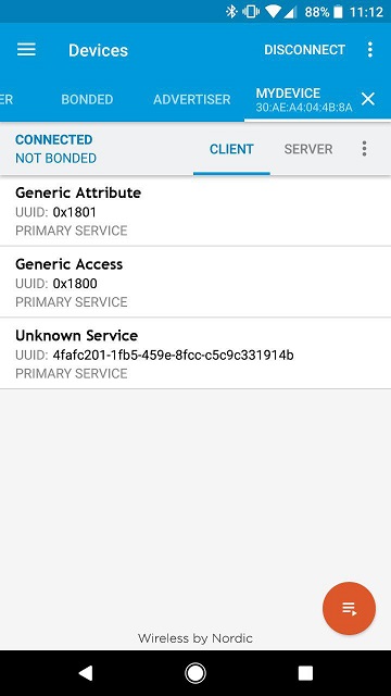

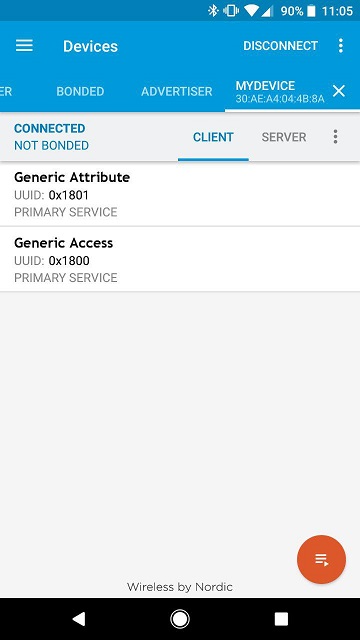

Hi Neil, thank you very much for your excellent work! I have a situation here: I'm trying to understand your BLE test based on Sample1.cpp, but when I compile and run the application it doesn't show the "Unknown Service" on my cell phone:
The weird thing is, if I change the default log verbosity from "Info" to "Debug" in "make menuconfig" and then recompile the project, then now I can see the "Unknown Service" on my cell phone:
Why do you think it is not working with "Info" verbosity?
Thanks in advance!
Thanks in advance!

I also have seen strange symptoms with the latest BLE code is the pre-GA 3.0 BLE support related to "race conditions". Inside the ESP-IDF BLE classes there are multiple tasks in flight. I believe that some of these may be racing each other. When we switch on additional logging, we are effectively synchronizing some work on the underlying (relatively slow) serial output. The unfortunate thing is thus that when we have a problem and switch on debugging, the problem disappears.
