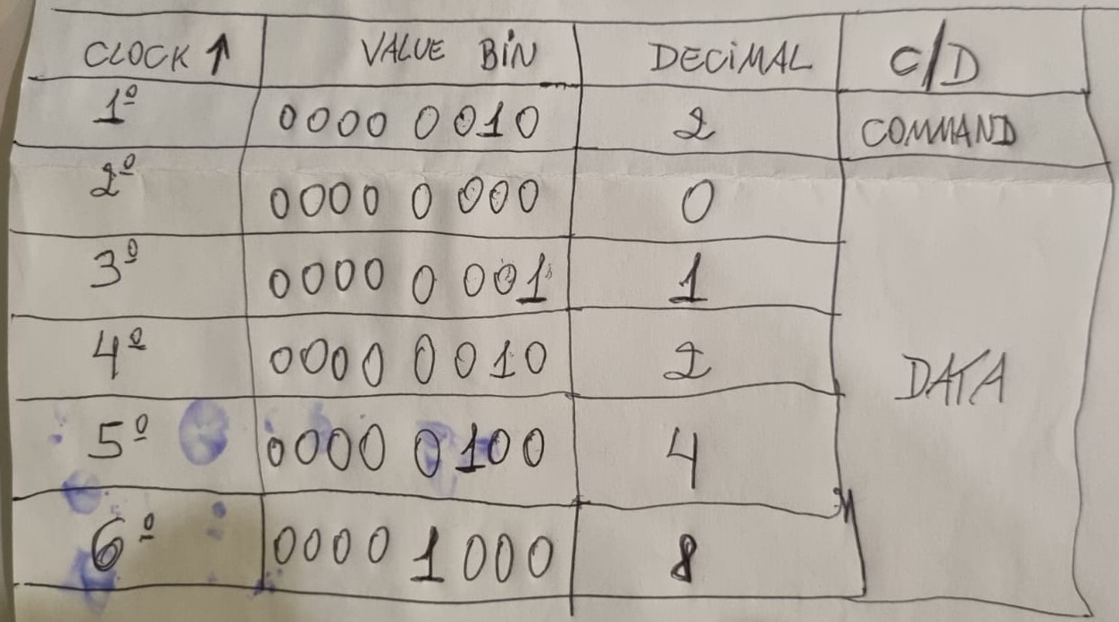

inline void hw_lcd_write_n_data( uint32_t command, uint8_t* data, uint32_t data_len )
    LCD_CAM.lcd_user.lcd_dout_cyclelen = data_len - 1;  // 0 = 1 single byte. LCD_CAM.lcd_user.lcd_always_out_en = 0;
    LCD_CAM.lcd_user.lcd_cmd = 1;
    LCD_CAM.lcd_user.lcd_dout = 1;
    LCD_CAM.lcd_cmd_val.lcd_cmd_value = command;
    hw_lcd_dma_tx_push_n_data( 0, data, data_len );
//    LCD_CAM.lcd_user.lcd_update = 1;
//    LCD_CAM.lcd_user.lcd_start = 1;

ESP-IDF MONITOR:
I (688) HW_LCD_DMA: GDMA HW Version: 0x02101180
I (695) HW_LCD: HW_LCD Information:
I (700) HW_LCD: LCD_CAM HW Version: 33566752
I (705) HW_LCD: HW_LCD_FREQ_HZ = 20 MHz
I (711) HW_LCD: WR io num = 4
I (716) HW_LCD: DC io num = 5
I (720) HW_LCD: CS io num = 6
I (725) HW_LCD: HW_LCD BUS Data Width = 8
I (730) HW_LCD: Data[0] = 7
I (735) HW_LCD: Data[1] = 15
I (739) HW_LCD: Data[2] = 16
I (744) HW_LCD: Data[3] = 17
I (748) HW_LCD: Data[4] = 18
I (753) HW_LCD: Data[5] = 8
I (757) HW_LCD: Data[6] = 3
I (762) HW_LCD: Data[7] = 46
r = ESP_OK

@ESP_Sprite,
I tested the program with the code below and it almost worked.
The problem is that second clock in the picture in annex shouldn't exist.
Should be:
command
0x02
Data
0x01, 0x02, 0x04, 0x08 // hw_lcd_write_n_data( 0x02, data, 4 );
Any suggestions from the digital team maybe ?!

Postby Sprite » Thu Jan 27, 2022 7:22 am
As I said before, official answer is 'wait until we finish the TRM, or contact the sales team if you're going to run production-volume numbers with this'.
With that being said, I do need to apologize as I offered to get you information informally, and I left you hanging there and I can imagine you feel frustrated with that. Sorry, that should not have happened.
With that being said, the issue is that I can't really find much wrong with your code... I have a few things you could check, maybe:
- Do you have LCD_CAM_LCD_DUMMY and LCD_CAM_LCD_CMD_2_CYCLE_EN set to 0?
- Not sure if that's 100% sure an issue if it isn't, but is data[] 4-byte aligned?
- Is there any way you can check your code with actual DMA, instead of pushing into the FIFO? As I said before, we think pushing into the FIFO should work, but it's relatively untested.

Postby Baldhead » Mon Feb 07, 2022 11:53 pm
Yes. The default value.
- Not sure if that's 100% sure an issue if it isn't, but is data[] 4-byte aligned ?
I declared data[] statically.
How can i align this data[] ?
I will try as soon as possible.
But the digital team can't give some tips about pushing data into fifo ?
Maybe a hardware test inside espressif.
