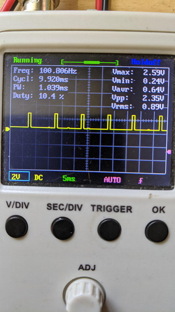

Hello I am trying to use your code to create a tachometer gauge that reads a pulsed signal and displays the output.
The signal to be read by the ESP32 is 2.6v and has pulses of 1m/s. But the problem is the frequency I read in the Serial Monitor is 5 times bigger than the actual frequency. The frequency is correctly displayed on the oscilloscope. (see picture attached). Can you tell me what is wrong?
