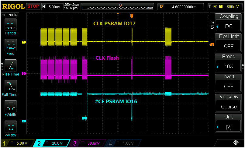

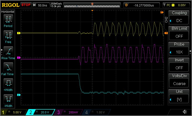

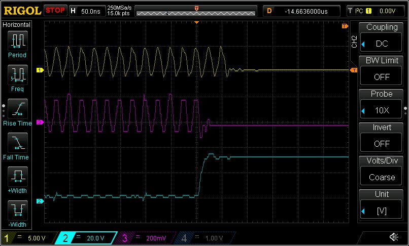

interesting, PSRAM & FLASH same QIO CLK time + frequency, why not share on 40MHz?
Because of SPI Read ID function only with 4 / 8 MHz ?
I think we can on custom mode the Read ID save and share the CLK in 40 MHz - would save a GPIO ( IO17 )
Posts: 1759
Re: ESP32 PSRAM support
Postby rudi ;-) » Wed Jul 12, 2017 1:06 am
flash clk comes 2 clks earlier -
_ psram clk need a cycl after #CE goes high for terminated_

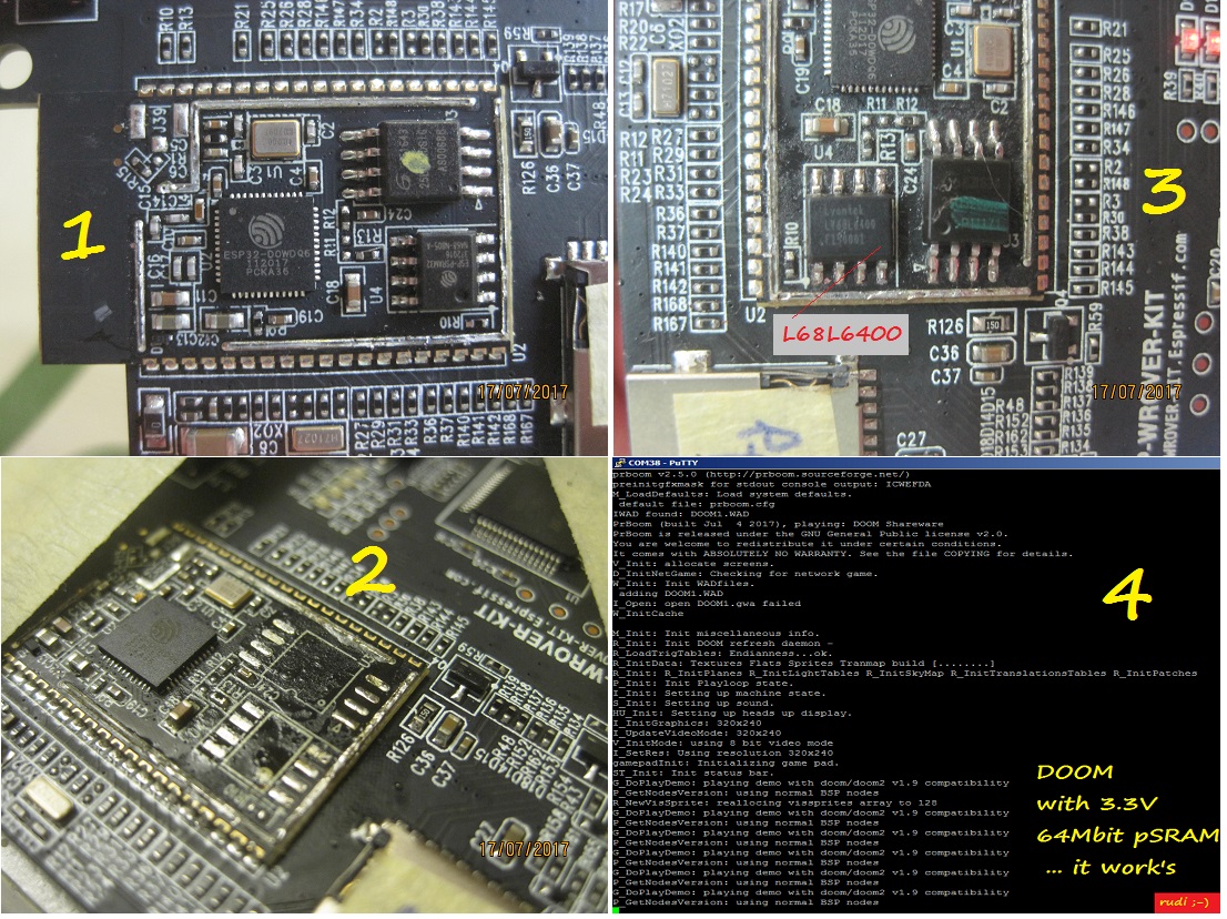

Today i got a parcel from switzerland and the guy did what he promissed.
i got today the long long waiting PSRAM in 3.3V and 64Mbit from Lyontek
it is the 64er L ( 3.3 ) version not S ( 1.8 ) version
so now, what i can do for the guy and you folks and me :)
i can test this on a Rev0 and Rev1 Silicon SoC ESP32.
First start was simple, does the 3.3V Version passes the ID Check.
This was done - and the ID Check passed successful
Then the next step was, to test this on a Rev1 and ... why not - i taked the Wrover-Kit where DOOM was run with 1.8V Flash and 1.8V ESP-PSRAM32 .
So i remove first the Case of wrover and saw, that the SoC was 112017 ( mmh ) and is still Rev1 ( mmh )
the next i remove the 1.8V ESP-PSRAM32 and the 1.8V Flash.

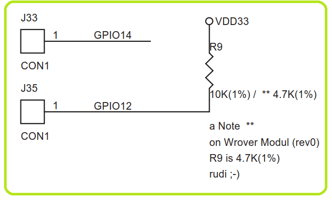

Then i solder the 3.3V PSRAM 64Mbit Version and a 3.3V Flash from a Wroom32 :)
the MTDI ( IO12 ) was then pulled down ( GND )
cause there is 10K Ohm in the pulled up bootstrap line ( R9 )
checked then the fine 3.3V that comes from VDD_SDIO intern regulator
After this steps i flashed the DOOM Firmware and....
... it work's!

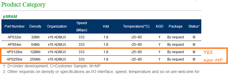

32, 64 ( 128 comes in August )
now MP also 256Mbit

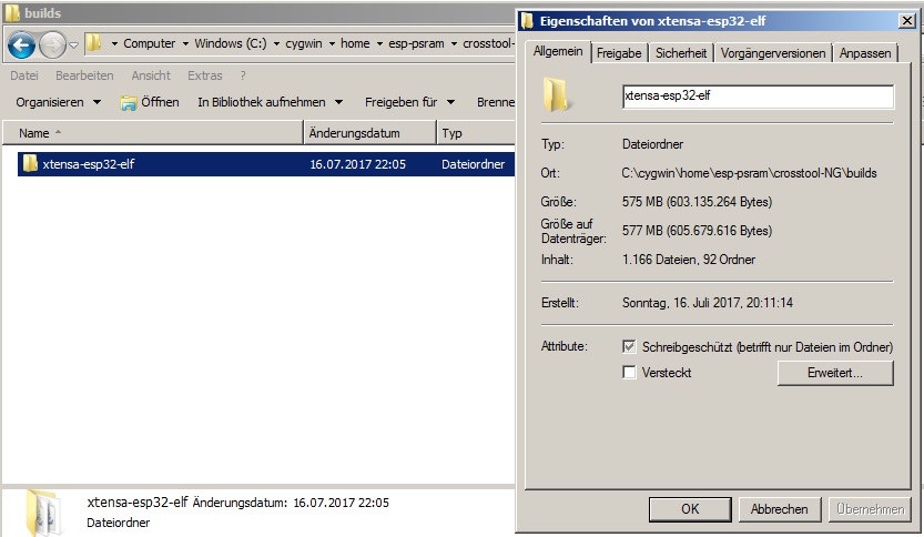

build.log
cygwin posix try build
(14.91 MiB) Downloaded 1618 times

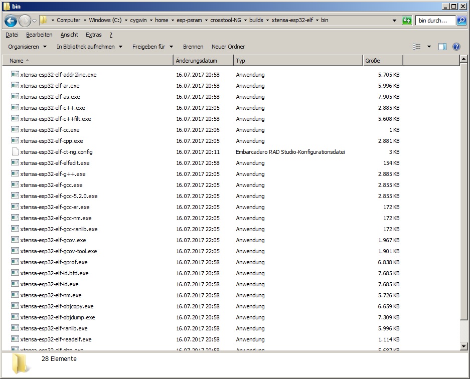

edit:
shortly last steps:
[ALL ] Making init.c
[ALL ] i686-build_pc-cygwin-gcc -g -O2 -I. -I/home/esp-psram/crosstool-NG/.build/src/gdb-7.10/gdb -I/home/esp-psram/crosstool-NG/.build/src/gdb-7.10/gdb/common -I/home/esp-psram/crosstool-NG/.build/src/gdb-7.10/gdb/config -DLOCALEDIR=""/home/esp-psram/crosstool-NG/builds/xtensa-esp32-elf/share/locale"" -DHAVE_CONFIG_H -I/home/esp-psram/crosstool-NG/.build/src/gdb-7.10/gdb/../include/opcode -I/home/esp-psram/crosstool-NG/.build/src/gdb-7.10/gdb/../opcodes/.. -I/home/esp-psram/crosstool-NG/.build/src/gdb-7.10/gdb/../readline/.. -I/home/esp-psram/crosstool-NG/.build/src/gdb-7.10/gdb/../zlib -I../bfd -I/home/esp-psram/crosstool-NG/.build/src/gdb-7.10/gdb/../bfd -I/home/esp-psram/crosstool-NG/.build/src/gdb-7.10/gdb/../include -I../libdecnumber -I/home/esp-psram/crosstool-NG/.build/src/gdb-7.10/gdb/../libdecnumber -I/home/esp-psram/crosstool-NG/.build/src/gdb-7.10/gdb/gnulib/import -Ibuild-gnulib/import -DTUI=1 -I/home/esp-psram/crosstool-NG/.build/xtensa-esp32-elf/buildtools/include -I/usr/include/python2.7 -I/usr/include/python2.7 -Wall -Wpointer-arith -Wno-unused -Wunused-value -Wunused-function -Wno-switch -Wno-char-subscripts -Wempty-body -Wpointer-sign -Wmissing-prototypes -Wdeclaration-after-statement -Wmissing-parameter-type -Wold-style-declaration -Wold-style-definition -Wformat-nonliteral -c -o init.o -MT init.o -MMD -MP -MF .deps/init.Tpo init.c
[ALL ] rm -f gdb.exe
[ALL ] i686-build_pc-cygwin-gcc -g -O2 -static-libstdc++ -static-libgcc -Wl,--stack,12582912 -o gdb.exe gdb.o xtensa-tdep.o xtensa-config.o solib-svr4.o ser-base.o ser-unix.o ser-pipe.o ser-tcp.o remote.o dcache.o tracepoint.o ax-general.o ax-gdb.o remote-fileio.o remote-notif.o ctf.o tracefile.o tracefile-tfile.o cli-dump.o cli-decode.o cli-script.o cli-cmds.o cli-setshow.o cli-logging.o cli-interp.o cli-utils.o mi-out.o mi-console.o mi-cmds.o mi-cmd-catch.o mi-cmd-env.o mi-cmd-var.o mi-cmd-break.o mi-cmd-stack.o mi-cmd-file.o mi-cmd-disas.o mi-symbol-cmds.o mi-cmd-target.o mi-cmd-info.o mi-interp.o mi-main.o mi-parse.o mi-getopt.o tui-command.o tui-data.o tui-disasm.o tui-file.o tui-hooks.o tui-interp.o tui-io.o tui-layout.o tui-out.o tui-regs.o tui-source.o tui-stack.o tui-win.o tui-windata.o tui-wingeneral.o tui-winsource.o tui.o python.o py-arch.o py-auto-load.o py-block.o py-bpevent.o py-breakpoint.o py-cmd.o py-continueevent.o py-xmethods.o py-event.o py-evtregistry.o py-evts.o py-exitedevent.o py-finishbreakpoint.o py-frame.o py-framefilter.o py-function.o py-gdb-readline.o py-inferior.o py-infevents.o py-infthread.o py-lazy-string.o py-linetable.o py-newobjfileevent.o py-objfile.o py-param.o py-prettyprint.o py-progspace.o py-signalevent.o py-stopevent.o py-symbol.o py-symtab.o py-threadevent.o py-type.o py-unwind.o py-utils.o py-value.o py-varobj.o guile.o elfread.o stap-probe.o dtrace-probe.o posix-hdep.o posix-strerror.o c-exp.o cp-name-parser.o ada-exp.o jv-exp.o d-exp.o f-exp.o go-exp.o m2-exp.o p-exp.o version.o annotate.o addrmap.o auto-load.o auxv.o agent.o bfd-target.o blockframe.o breakpoint.o break-catch-sig.o break-catch-throw.o break-catch-syscall.o findvar.o regcache.o cleanups.o charset.o continuations.o corelow.o disasm.o dummy-frame.o dfp.o source.o value.o eval.o valops.o valarith.o valprint.o printcmd.o block.o symtab.o psymtab.o symfile.o symfile-debug.o symmisc.o linespec.o dictionary.o infcall.o infcmd.o infrun.o expprint.o environ.o stack.o thread.o exceptions.o extension.o filesystem.o filestuff.o inf-child.o interps.o minidebug.o main.o macrotab.o macrocmd.o macroexp.o macroscope.o mi-common.o event-loop.o event-top.o inf-loop.o completer.o gdbarch.o arch-utils.o gdbtypes.o gdb_bfd.o gdb_obstack.o osabi.o copying.o memattr.o mem-break.o target.o target-dcache.o parse.o language.o build-id.o buildsym.o findcmd.o std-regs.o signals.o exec.o reverse.o bcache.o objfiles.o observer.o minsyms.o maint.o demangle.o dbxread.o coffread.o coff-pe-read.o dwarf2read.o mipsread.o stabsread.o corefile.o dwarf2expr.o dwarf2loc.o dwarf2-frame.o dwarf2-frame-tailcall.o ada-lang.o c-lang.o d-lang.o f-lang.o objc-lang.o ada-tasks.o ada-varobj.o c-varobj.o ui-out.o cli-out.o varobj.o vec.o go-lang.o go-valprint.o go-typeprint.o jv-lang.o jv-valprint.o jv-typeprint.o jv-varobj.o m2-lang.o opencl-lang.o p-lang.o p-typeprint.o p-valprint.o sentinel-frame.o complaints.o typeprint.o ada-typeprint.o c-typeprint.o f-typeprint.o m2-typeprint.o ada-valprint.o c-valprint.o cp-valprint.o d-valprint.o f-valprint.o m2-valprint.o serial.o mdebugread.o top.o utils.o ui-file.o user-regs.o frame.o frame-unwind.o doublest.o frame-base.o inline-frame.o gnu-v2-abi.o gnu-v3-abi.o cp-abi.o cp-support.o cp-namespace.o reggroups.o trad-frame.o tramp-frame.o solib.o solib-target.o prologue-value.o memory-map.o memrange.o xml-support.o xml-syscall.o xml-utils.o target-descriptions.o target-memory.o xml-tdesc.o xml-builtin.o inferior.o osdata.o gdb_usleep.o record.o record-full.o gcore.o gdb_vecs.o jit.o progspace.o skip.o probe.o common-utils.o buffer.o ptid.o gdb-dlfcn.o common-agent.o format.o registry.o btrace.o record-btrace.o waitstatus.o print-utils.o rsp-low.o errors.o common-debug.o debug.o common-exceptions.o btrace-common.o fileio.o compile.o compile-c-symbols.o compile-c-types.o compile-object-load.o compile-object-run.o compile-loc2c.o compile-c-support.o inflow.o init.o ../readline/libreadline.a ../opcodes/libopcodes.a ../bfd/libbfd.a -L./../zlib -lz ../libiberty/libiberty.a ../libdecnumber/libdecnumber.a -lncurses -lm -liconv -ldl -lpython2.7 /home/esp-psram/crosstool-NG/.build/xtensa-esp32-elf/buildtools/lib/libexpat.a ../libiberty/libiberty.a -luser32 build-gnulib/import/libgnu.a
[ALL ] tui-win.o: In function `tui_update_variables':
[ALL ] /home/esp-psram/crosstool-NG/.build/src/gdb-7.10/gdb/tui/tui-win.c:301: undefined reference to `acs_map'
[ALL ] /home/esp-psram/crosstool-NG/.build/src/gdb-7.10/gdb/tui/tui-win.c:310: undefined reference to `acs_map'
[ALL ] /home/esp-psram/crosstool-NG/.build/src/gdb-7.10/gdb/tui/tui-win.c:307: undefined reference to `acs_map'
[ALL ] /home/esp-psram/crosstool-NG/.build/src/gdb-7.10/gdb/tui/tui-win.c:304: undefined reference to `acs_map'
[ALL ] /home/esp-psram/crosstool-NG/.build/src/gdb-7.10/gdb/tui/tui-win.c:297: undefined reference to `acs_map'
[ALL ] tui-win.o:/home/esp-psram/crosstool-NG/.build/src/gdb-7.10/gdb/tui/tui-win.c:313: more undefined references to `acs_map' follow
[ALL ] tui-win.o: In function `tui_refresh_all_win':
[ALL ] /home/esp-psram/crosstool-NG/.build/src/gdb-7.10/gdb/tui/tui-win.c:698: undefined reference to `curscr'
[ALL ] tui-win.o: In function `tui_resize_all':
[ALL ] /home/esp-psram/crosstool-NG/.build/src/gdb-7.10/gdb/tui/tui-win.c:780: undefined reference to `stdscr'
[ALL ] /home/esp-psram/crosstool-NG/.build/src/gdb-7.10/gdb/tui/tui-win.c:781: undefined reference to `curscr'
[ALL ] /home/esp-psram/crosstool-NG/.build/src/gdb-7.10/gdb/tui/tui-win.c:782: undefined reference to `stdscr'
[ALL ] tui.o: In function `tui_enable':
[ALL ] /home/esp-psram/crosstool-NG/.build/src/gdb-7.10/gdb/tui/tui.c:437: undefined reference to `stdscr'
[ALL ] /home/esp-psram/crosstool-NG/.build/src/gdb-7.10/gdb/tui/tui.c:460: undefined reference to `LINES'
[ALL ] /home/esp-psram/crosstool-NG/.build/src/gdb-7.10/gdb/tui/tui.c:461: undefined reference to `COLS'
[ALL ] /home/esp-psram/crosstool-NG/.build/src/gdb-7.10/gdb/tui/tui.c:476: undefined reference to `stdscr'
[ERROR] collect2: error: ld returned 1 exit status
[ALL ] Makefile:1390: recipe for target 'gdb.exe' failed
[ERROR] make[3]: *** [gdb.exe] Error 1
[ALL ] make[3]: Leaving directory '/home/esp-psram/crosstool-NG/.build/xtensa-esp32-elf/build/build-gdb-cross/gdb'
[ALL ] Makefile:8758: recipe for target 'all-gdb' failed
[ERROR] make[2]: *** [all-gdb] Error 2
[ALL ] make[2]: Leaving directory '/home/esp-psram/crosstool-NG/.build/xtensa-esp32-elf/build/build-gdb-cross'
[ALL ] Makefile:848: recipe for target 'all' failed
[ERROR] make[1]: *** [all] Error 2
[ALL ] make[1]: Leaving directory '/home/esp-psram/crosstool-NG/.build/xtensa-esp32-elf/build/build-gdb-cross'
[ERROR]
[ERROR] >>
[ERROR] >> Build failed in step 'Installing cross-gdb'
[ERROR] >> called in step '(top-level)'
[ERROR] >>
[ERROR] >> Error happened in: CT_DoExecLog[scripts/functions@257]
[ERROR] >> called from: do_debug_gdb_build[scripts/build/debug/300-gdb.sh@120]
[ERROR] >> called from: do_debug[scripts/build/debug.sh@35]
[ERROR] >> called from: main[scripts/crosstool-NG.sh@646]
[ERROR] >>
[ERROR] >> For more info on this error, look at the file: 'build.log'
[ERROR] >> There is a list of known issues, some with workarounds, in:
[ERROR] >> 'docs/B - Known issues.txt'
[ERROR]
[ERROR] (elapsed: 133:44.83)
$ ./xtensa-esp32-elf-gcc.exe -v
Using built-in specs.
COLLECT_GCC=./xtensa-esp32-elf-gcc
COLLECT_LTO_WRAPPER=/home/esp-psram/crosstool-NG/builds/xtensa-esp32-elf/libexec/gcc/xtensa-esp32-elf/5.2.0/lto-wrapper.exe
Target: xtensa-esp32-elf
Configured with: /home/esp-psram/crosstool-NG/.build/src/gcc-5.2.0/configure --build=i686-build_pc-cygwin --host=i686-build_pc-cygwin --target=xtensa-esp32-elf --prefix=/home/esp-psram/crosstool-NG/builds/xtensa-esp32-elf --with-local-prefix=/home/esp-psram/crosstool-NG/builds/xtensa-esp32-elf/xtensa-esp32-elf/sysroot --with-sysroot=/home/esp-psram/crosstool-NG/builds/xtensa-esp32-elf/xtensa-esp32-elf/sysroot --with-newlib --enable-threads=no --disable-shared --with-pkgversion='crosstool-NG crosstool-ng-1.22.0-64-g47d56eb' --disable-__cxa_atexit --enable-cxx-flags='-fno-exceptions -fno-rtti' --with-gmp=/home/esp-psram/crosstool-NG/.build/xtensa-esp32-elf/buildtools --with-mpfr=/home/esp-psram/crosstool-NG/.build/xtensa-esp32-elf/buildtools --with-mpc=/home/esp-psram/crosstool-NG/.build/xtensa-esp32-elf/buildtools --with-isl=/home/esp-psram/crosstool-NG/.build/xtensa-esp32-elf/buildtools --with-cloog=/home/esp-psram/crosstool-NG/.build/xtensa-esp32-elf/buildtools --with-libelf=/home/esp-psram/crosstool-NG/.build/xtensa-esp32-elf/buildtools --enable-lto --enable-target-optspace --without-long-double-128 --disable-libgomp --disable-libmudflap --disable-libssp --disable-libquadmath --disable-libquadmath-support --disable-nls --disable-multilib --enable-languages=c,c++ --disable-libstdcxx-verbose
Thread model: single
gcc version 5.2.0 (crosstool-NG crosstool-ng-1.22.0-64-g47d56eb)
it is not 100 prozent finished -
so just in time - you must build the toolchain under linux.
next days i will try again

build.log
(I am unfortunately for 1 1/2 weeks (summer flu)
Can not be as I would like.)
if the cygwin build is 100 prozent successful then i will upload the toolchain -
and write the steps in windows for build it with cygwin ( posix )
hope this helps?!
