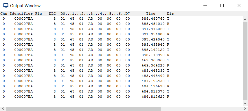

Kvaser log, I sent 8 zeros in the first three packets, then 0, 52 then six zeroes in the subsequent packets and the ESP32 echoes them.
The 2018 is the CAN ID, 8 is the DLC, then the payload, then the timestamp and Transmit or Receive.
 0        2018         8   0   0   0   0   0   0   0   0      66.129150 T

What is interesting is the round trip time varies from 1ms to 8ms. 500kbps bus, nothing else on the bus. Any ideas on getting the latency lower? It isn't bad, but my 180MHz ECU usually replies in 1ms to Kvaser.

While the rx frame is handled in an ISR, the tx frame is send in a task context. As we have plenty of tasks for wifi etc. you can not know if there are currently higher priority tasks pending and as the tx task has no synchronisation point, the delay jitters.
You can place the tx directly in the rx is context or try to increase the tx task priorit to remove or reduce jitter.

First eight packets are with a FreeRTOS task replying with an echo of packets received, so four are sent, four received. Second eight packets are with the reply in an ISR. Moving from FreeRTOS to an ISR drops the latency 20 times from average of 5.3ms to 260us.

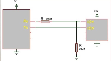

In relation to the nature of the question, first,
how you want drive CAN on ESP32?
MCP2551, TJA1051, SN65HVD233
5V / 3.7V / 3.3V
cause ESP32 is 3.3V - be sure your Receive Lines are LevelShifted to 3.3V
example MCP2551 is 5V and on Rx Line, this comes from MCP2551 and goes to ESP32 GPIO PIN; without a resistor / levelshift this can destroy your gpio cause 5V line....
.. there are several examples how you can do 5V Transceiver to a 3.3V Controller
example look how olimex this do..
or you can use 3.3V CAN Transceiver example sn65hvd233.

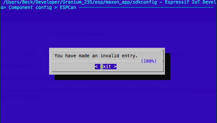

When I configure the driver with different pinout, in my case is GPIO5->CAN TX and GPIO16->CAN RX, the menuconfig shows they are invalid pins. Running the code on both device successfully, but no communication yet. Is there a way to change the GPIO pinout for CAN bus?
Platform: ESP-IDF
Board: ESP-WROOM-32
CAN Transceiver: SN65HVD232 (3.3V)
Termination: 120 Ohm

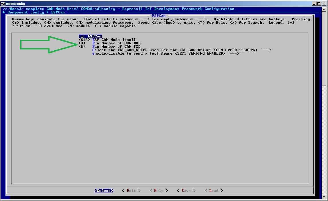

it is cause the pins are selected as "Valid pins" in the menuconfig file for CAN-
feel free to set your own "Valid" config on this
change here the "valid pins" and here
4 and 5 are the successfully tested pins,
you can use other too
