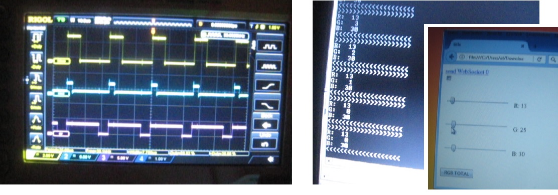

hi guys,
my wsock test with highspeed pwm on RGB on wRover Kit V2
debug prints on uart console
duty set by wifi browser/wsock.
if you want you can see here a short animation sequence

works.

update
#define LEDC_CONF_REG (DR_REG_LEDC_BASE + 0x0190)
/* LEDC_APB_CLK_SEL : R/W ;bitpos:[0] ;default: 1'b0 ; */
/*description: This bit is used to set the frequency of slow_clk. 1'b1:80mhz 1'b0:8mhz*/
ok, SLOW_CLOCK source can be either
APB_CLK (80 MHz) or 8 MHz, and can be selected using LEDC_APB_CLK_SEL
and this change/set to 80mhz works:
//80mhz
WRITE_PERI_REG (LEDC_CONF_REG, (1<<0));
__asm__ __volatile__("nop;nop;nop;nop;nop;nop;nop;nop;");
uint32_t val=0;
val = READ_PERI_REG (LEDC_CONF_REG);
printf("LEDC_CONF_REG: 0x%X\n", val);
LEDC_CONF_REG: 0x1
channel bind works too,
LED get on if Clock set to 80mhz
/* LEDC_LS_SIG_OUT0_IDX 79 */
  WRITE_PERI_REG (GPIO_FUNC2_OUT_SEL_CFG_REG, (1<<10)|82);  // Green  79 + cn 3
  WRITE_PERI_REG (GPIO_FUNC4_OUT_SEL_CFG_REG, (1<<10)|83);  // Blue   79 + cn 4
  WRITE_PERI_REG (GPIO_FUNC0_OUT_SEL_CFG_REG, (1<<10)|81);  // Red    79 + cn 2
but i am not sure, that i use the right config for the low speed timer , this (1<<26) is not right.
  WRITE_PERI_REG (LEDC_LSTIMER0_CONF_REG, (1<<26) | (1<<25)|        (0b000000001000000000<<5)|10);
i play with duty and measurement, can't see a difference, perhabs the update code is wrong?
  WRITE_PERI_REG (LEDC_LSCH2_DUTY_REG, (dutyCycleG * DUTY_CYCLE_MAX / 100) << 4);
  WRITE_PERI_REG (LEDC_LSCH2_CONF1_REG, (1<<31));
  WRITE_PERI_REG (LEDC_LSCH3_DUTY_REG, (dutyCycleB * DUTY_CYCLE_MAX / 100) << 4);
  WRITE_PERI_REG (LEDC_LSCH3_CONF1_REG, (1<<31));
  WRITE_PERI_REG (LEDC_LSCH4_DUTY_REG, (dutyCycleR * DUTY_CYCLE_MAX / 100) << 4);
  WRITE_PERI_REG (LEDC_LSCH4_CONF1_REG, (1<<31));
pausing
