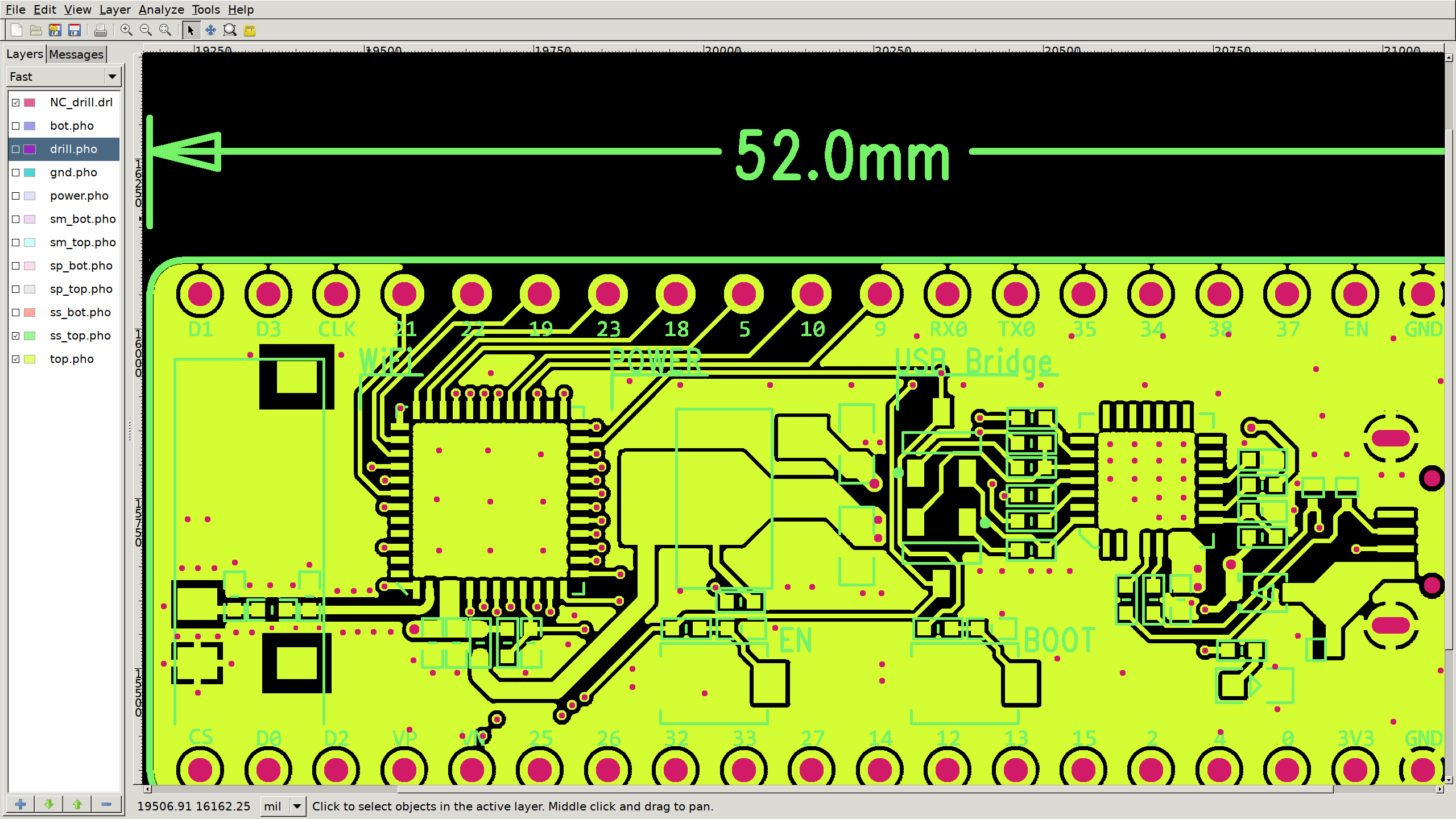

can someone explain me how is the GND (PIN 49) of ESP32 PICO D4 connected to the PCB board. I have checked the Gerber files (all layers), but there is no connection to GND.

but this is strange, because on schematic I can only see one PIN which is connected to GND and its PIN 49.
So the question is, where is GND?

FWIW, pin 49 indeed is the only GND pad on the PicoD4 and as such must be connected. From what I remember, the remark that the middle pad is only a thermal pad is valid for the non-Pico ESP32s though.
dark99dark: You're looking at the layers, but you probably also should look at the drill files. There's an array of 9 plated vias connecting the bottom pad with the ground layer:
