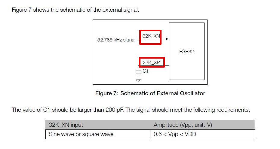

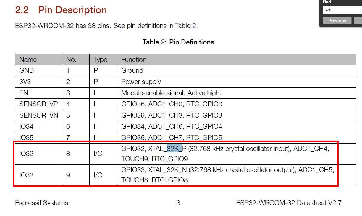

But if I read the latest documentation about RTC clock sources in the esp32_hardware_design_guidelines.pdf and esp32-wroom-32_datasheet.pdf and esp32_technical_reference_manual.pdf and KConfig online help (section ESP32_RTC_CLOCK_SOURCE) then the instructions are significantly different from each other. So I do not know which one is correct and if my own setup is still supported. I'm probably not understanding things correctly.
The esp32_hardware_design_guidelines.pdf:
The esp32-wroom-32_datasheet.pdf:

So I have conducted some tests to see which ones are working in combination with the DS3231. The tests were performed on a breadboard.
Test#1 (my setup):
- Menuconfig: "(*) External 32kHz oscillator at 32K_XP pin"
- RTC board pin "32K" => 10K pullup resistor => MCU VCC 3.3V (this is specific for the DS3231)
- MCU GPIO#33 32K_XN => RTC board pin "32K"
- MCU GPIO#32 32K_XP not connected.
D (454) clk: waiting for 32k oscillator to start up
D (521) clk: RTC_SLOW_CLK calibration value: 15999987
Result: Ok. The external signal is used. The ESP32 returns from deep sleep.
Test#2 (the setup of esp32_hardware_design_guidelines.pdf):
- MCU GPIO#33 32K_XP => 10nF/50nF cap => GND (all cap values were tested)
D (453) clk: waiting for 32k oscillator to start up
D (521) clk: RTC_SLOW_CLK calibration value: 15999989
Result: Error. The external signal is used. But the ESP32 never returns from deep sleep.
Test#3 (the setup as described in the online help of KConfig ESP32_RTC_CLOCK_SOURCE):
- MCU GPIO#33 32K_XP => RTC board pin "32K"
- MCU GPIO#33 32K_XN => 10nF/50nF cap => GND (all cap values were tested)
W (539) clk: 32 kHz XTAL not found, switching to internal 150 kHz oscillator
D (547) clk: RTC_SLOW_CLK calibration value: 3133542
Result: Error. The external signal is not used; it reverts back to the internal 150 kHz oscillator. The ESP32 returns from deep sleep but it used the internal 150 kHz oscillator.
=> To conclude, can you please help me out?
- What is the correct hardware setup for an external 32Khz oscillator signal?
- Should MCU GPIO#33 32K_XP be left not-connected when wiring an external oscillator to MCU GPIO#33 32K_XN? So the pin cannot be used for other purposes in this case?
- Is it possible that the DS32131 RTC is not suitable for this task?
- Should I upgrade to ESP-IDF v3.3?
Paul.
- RTC board pin "32K" => 10K pullup resistor => Power rail 0.8V (this pullup is specific for the DS3231)
- MCU GPIO#33 32K_XN => 10nF/50nF cap => GND (each cap value was tested)
D (521) clk: RTC_SLOW_CLK calibration value: 16000000
Result: Ok (**now it works!**). The external signal is used. The ESP32 returns from deep sleep.
=> The Test#3 (the setup as described in the online help of KConfig ESP32_RTC_CLOCK_SOURCE) works correctly. The Test#2 (the setup of esp32_hardware_design_guidelines.pdf) fails.
The schematic "Figure 7: Schematic of External Oscillatorin" in esp32_hardware_design_guidelines.pdf is probably wrong or incomplete (pins swapped?).
I will change the PCB to what is described under Test#3. It means adding more external components (0.8V) but that is fine.
Paul.

The situation looks quite confusing: do we have to connect an external 32,768 oscillator onto 32K_XN or 32K_XP?
The 'menuconfig' options still looks in conflict with the hardware guidelines document..
In this case (external oscillator connected to the right pin), is the other pin available as a GPIO.
