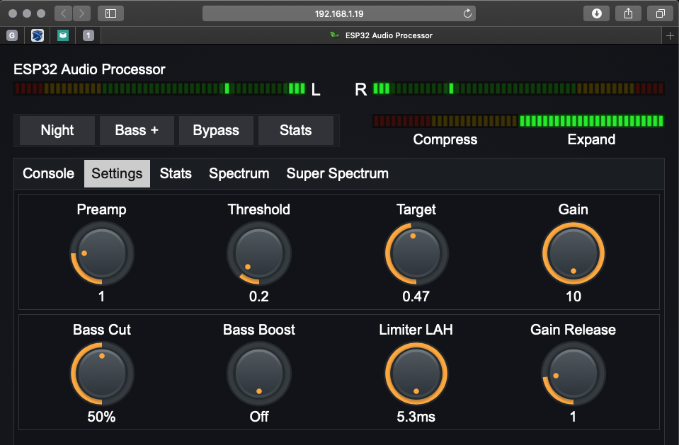

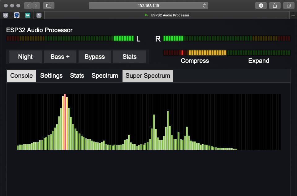

Should be fine, WROOM32 (no psram) will do stereo MP3 encode and http stream, stereo EQ via 2048 point FFT (so that's FFT and iFFT) and a constant Q spectrum output via websockets to http clients simultaneously. Note though,I believe the ADK expects psram.
So you should be ok, but my only tip is that I decided to go the web client route rather than try to have a realtime colour display because the web client version was better looking, used far less IO and memory and allows the client to control the device.
Using websockets Safari and Chrome push 30fps no problem with 128 bars on the spectrum, wifi esp to wifi laptop via modem/router. Chrome on Windows 10 also fine haven't tested Edge, Firefox is less efficient but works fine. I still output the spectrum and VU to serial and have a different uC do the display but for my project the display is more annoying than useful and is currently off.

Video example with audio captured from laptop mic to show sync.
https://youtu.be/l2k0qsd11yg?t=195

Here is a video from months back while testing the constant Q spectrum.
EDIT Changed video to Youtube:
Note that my laptop was struggling with the video capture and the web UI performance is better. I had my usual 100+ tabs open i guess.
The audio is NOT recorded directly from the audio processor but from the mic in the laptop to prove the fast realtime response of the web UI.
