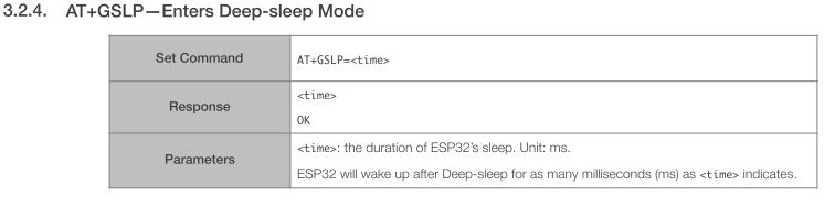

hi
can you test AT Firmware for a compare?
AT+GSLP=10000
goes deep sleep for 10000ms
